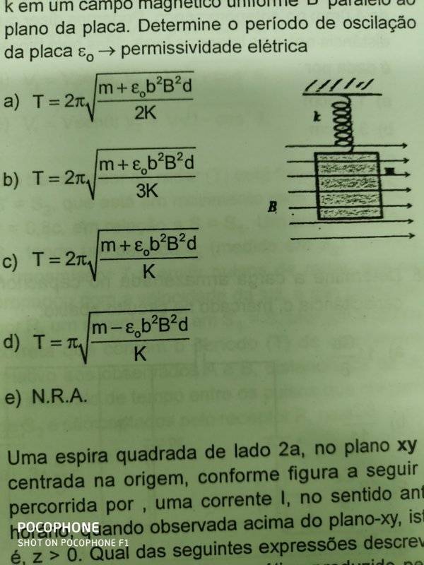

A plate of cupper with mass m has a square shape with side length b and thickness d. The plate is suspended vertically by a spring with constant k in an uniform magnetic field horizontal and parallel with the plates plane. Find the period of vertical oscillations of the plate
Fel=kx, U=d(flux)/dt, T=2pi √m/keq
Tried to find the resultant force, but I can't see how the magnetic field affects. I used Faraday's law to find the the diferece of potentials in the plate which should be B.d.v, where v is the vertical velocity of plate, but there were not given the resistance or resistivity to relate with the current and afterwards with the magnetic force

Yes, there will be a "motional emf" in the plate equal to ##B \, d \, v##. Can you find the electric field ##E## associated with this emf? Can you find the surface charge distribution ##\sigma## on the plate that produces the electric field?
The general idea is that as the plate changes its speed, ##\sigma## will change. There will be a current associated with the change in ##\sigma##. The magnetic field causes a force on the current.
Another approach is to use energy concepts. There is an energy associated with the electric field induced in the plate. If you include this energy as part of the total energy of the system, then you can deduce the answer from the form of the total energy.

Do this the easy way!:
What if B=0? (eliminates a,b)
Will B make T longer or shorter? (eliminates d)
If m=0 it will not oscillate (eliminates a,b,c)
Sorry, what is answer e? ...

Since the answers are all different even if the B field is zero, set the B to zero and solve.
Answer is c. Or e.
Answer is c. Or e.
Yes
Thanks for the confirmation. If given as an elementary problem, I find it to be misguided, particularly when it ignores the really useful viscous drag which, even in this geometry, will dominate in the real world. I hope @Moara understands this.

after further thought I'm thinking (a) there are no currents anywhere so my previous posts were irrelevant; (b) there
are Em and Es fields, equal & opposite, = Bvd, , all over the plate's insides, pointing front to back & reverse depending on mass motion direction. Tbis implies static charges all over the back and front of the plate also alternating with said motion.
I've read your posted energy argument but I can't see physically how that works. Something must apply force to the mass somehow, other than kx or mg. Don't see the charges in this. v x B is in the wrong direction
I'm hoping "N.R.A." is Portuguese for "none of the above". :smile:

Deleting my post. Have realized this problem is far more complicated than it appeared at first glance. Better leave it to T.Sny et al !
Re query on meaning of option E:
Asking "Uncle Google" to translate "none of the answers above" I get "nenhuma das respostas acima" and I guess NRA would be the abbreviation for that.
Thanks for translation.

If we follow the lines of reasoning in posts 23 and 26:
## E_s = Bv ##
D = ## \epsilon_0 E_s = \epsilon_0 Bv ##
## \sigma = D ## where σ = surface charge density
Q = σA = ## \epsilon_0 Bvb^2 ##
i = dQ/dt = ## \epsilon_0 Bb^2 dv/dt ##
Now the equation of motion becomes
## m\ddot y = -mg -ky - Bid ##
but ## dv/dt = d^2y/dt^2 ## so the equation of motion becomes
## (m + B^2d\epsilon_0b^2)\ddot y + ky = -mg ##
and the obvious effect of B is to change ##\omega^2 ## from the usual k/m to
## \omega^2 = \frac k {(m + B^2d\epsilon_0b^2)} ##
with the new period T = 2π/ω = ## 2\pi(\frac {m + b^2d\epsilon_0 B^2} k)^{1/2} ##
so the answer is (c).

I did it slightly differently. I worked out the drag for arbitrary acceleration (not just SHM), and then F/a is the increased effective mass. No need for relativity, again - except that Maxwell's equations are relativity.
