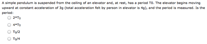

Elevetor and acceleration as elevator goes up - algebra involved?
2 replies · 2K views
riseofphoenix
294
Period for pendulum is T = 2π√(L/g)
When a pendulum is in an elevator and it goes up
T = 2π√(L/9.8+a)
At rest:
T = T0
Elevator moves upward with constant acceleration a = 3g
T = 2π√(L/9.8+3g)
So I have to solve for T0
T0 = [STRIKE]2π[/STRIKE]√(L/9.8+a) = [STRIKE]2π[/STRIKE]√(L/9.8+3g)
T0 = (√(L/9.8+a))2 = (√(L/9.8+3g))2
T0 = L/(9.8+a) = L/(9.8+3g)
T0 = [ L/9.8+a ] / [ L/9.8+3g ]
T0 = [STRIKE]L[/STRIKE](9.8 + a) / [STRIKE]L[/STRIKE](9.8 + 3g)
T0 = (9.8 + a) / (9.8 + 3g)
I'm not sure I'm doing this right... Help?
Wait...the period doesn't change if it's moving upward at constant acceleration...
So the answer would be 2*T0 right?
No, that would be true at constant velocity
T = 2π√(L/9.8+a)
T = 2π√(L/9.8+3g)
It helps to get the parentheses right. Can you write that equation correctly?
No, T0 is the period when a = 0.
Write out the correct equation for that and the equation for T when a = 3g.
