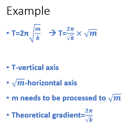

I am supposed to be graphing sqrt(L), not sqrt(2L). Here's an example of "m" being "processed", I am guessing processed just means to separate the equation into y = mx+c structure, where T is period, m is the gradient, x is the independent variable (m), and c is the y-intercept. This example however may not be applicable to the T = 2πsqrt(2L/3g) equation I gave earlier, if so please confirm if possible, thanks! I am assuming T = 2π/√(3g) * √(2L) is the correct way?
Physics Curiosity said:
I am supposed to be graphing sqrt(L), not sqrt(2L). Here's an example of "m" being "processed", I am guessing processed just means to separate the equation into y = mx+c structure, where T is period, m is the gradient, x is the independent variable (m), and c is the y-intercept.View attachment 327727
You mean "x is the independent variable (√m)", right?
My reading of this is that "processing" consists here in taking the square root of the value, not isolating it in the original equation. Imagine you have, in some plotting software, a column with values of T and another with values of m. Before you can make the plot (if you want the result to be linear), you need to process ##m## to ##\sqrt{m}##, i.e., take the square root of the values of m.
