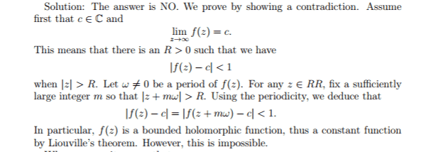

I am wanting to show that
##lim_{z\to\infty} f(z)=c## does not exist for ##c \in C##, ##C## the complex plane, where ##f## is non-constant periodic meromorphic function. (elliptic)
So I want to proove this is not true
Beginning with the definition:
For any ##\epsilon >0## can find a ##R## s.t ##|z|>R \implies |f(z)-c|<\epsilon## (1)
Now let ##w## be a period.
Then we also have
##|f(z+mw)-c|<\epsilon##(2), for ##m## some integer
Now I attach the solution:
Questions:
- I thought that (2) would hold automatically, from (1) by periodicty, without additionally needing to have ##|z+mw |>R ##
- Also this would hold following from (1), if not using periodicity, but simply looking at ##|z+mw |>R ##, for ##z## large since a shift by some constant is insignificant? Therefore in the solution, I do not understand the need to specify both, by periodicity and include this condition ##|z+mw |>R ##
- Finally I do not understand the conclusion itself, perhaps due to being unclear on the above points- I understand the goal is to show that if this limit exists it implies that ##f## is holomoprhic (since I then have the theorem that an elliptic function holomorphic is constant, and so proof by contradiction).
I do not understand the conclusion that
##|f(z)-c|=|f(z+mw)-c|<1## (3) implies the ##f(z)## is a bounded holomorphic function.
My interpretation is that since we can vary ##m## to cover a range of values of ##f(z)## which are bounded this conclusion is made? So ##m## generating a lot of points? However isn't this only for large ##z## ? We have only showed bounded for large ##z##? (When ##|z|>R## is satisfied)? Or am I barking up the wrong tree as to why we conclude ##f(z)## is constant from (3)?
Many thanks in advance
Your (2) is valid for |z|>R, but that is not really what you want to show.
You want to show that |f(z)-c| < ##\epsilon## for all z, including those not larger than R in magnitude. So you need the reverse direction. Start with those z, then find (using periodicity) a complex value with a magnitude larger than R.
If f(z) does not differ from c by more than 1 for all z, it is bounded. A bounded meromorphic function is constant.

So this is ##|z+mw|## but then how does this show that |f(z)-c| < ##\epsilon## for all z, including those not larger than R in magnitude?
Because we can choose any ##m## integer to make this small?
We can choose an m such that |z+mw|>R, and there we know that |f(z+mw)-c|< ϵ.

Ok, think I may understand at last, so whilst ##|f(z+mw)-c|<\epsilon## could simply follow from a condition only on ##z## , ##|z|>R## , by periodicity, this is still only considering large ##z##.
However if we instead have ##|z+mw|>R##, than the periodicity can be used to make |z+mw| large through ##m## and not ##z##, and so it holds for small ##z## too?
I don't understand your last post.
Let's make an example, maybe that is easier to understand.
##\epsilon=0.01##, R=1, w=0.5, c=3.
For |z|>1, we know that |f(z)-3|<0.01, or, in words, f(z) is close to 3. We want to show that f(z) is close to 3 everywhere.
What about z=0.2? We don't have direct condition on that, because 0.2<R. But we know f(0.2)=f(0.7)=f(1.2), and |f(1.2)-3|<0.01, i. e. f(1.2) is close to 3. Therefore, |f(0.2)-3|<0.01, which means f(0.2) is close to 3 as well.
z=-0.4+0.2i? Same idea: f(-0.4+0.2i) = f(1.1+0.2i), and |1.1+0.2i|>1. Again we can conclude that |f(-0.4+0.2i)-3|<0.01.
This approach works for all z with |z|<1. Therefore, |f(z)-3|<0.01 for all z.
We can repeat this with every ##\epsilon>0##, and conclude that |f(z)-3|<##\epsilon## for all ##\epsilon##. Therefore, f(z)=3 everywhere.
