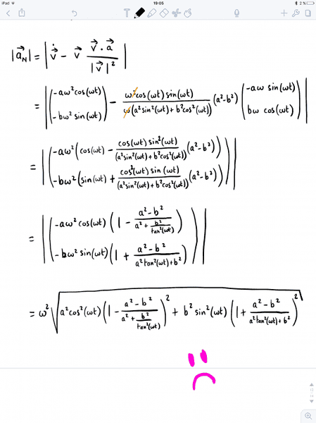

Here is what here is what I get using the 1st method now. Still not looking good, I've attached it because it's really hard to type it with LaTex...
  • Handwritten derivation on a tablet of the normal acceleration magnitude |a_N| = |v-dot - v-vector (v-vector dot a-vector)/|v|^2|, simplified step by step into a square-root expression containing omega squared, a, b, cos(omega t) and sin(omega t), with a frowning face drawn in pink below.

No need to do that terrible calculation if you need only the magnitude of aN. Just use
JulienB said:
[tex]=\vec a{_N}= \vec a - \vec{v} \frac{\vec{v} \cdot \vec{a}}{|\vec{v}|^2}[/tex]
You need the magnitude. Take the product with itself and take the square root. You get
[tex]a_N^2= \left( \vec a - \vec{v} \frac{\vec{v} \cdot \vec{a}}{|\vec{v}|^2}\right)^2 =\frac{( \vec a )^2 (\vec v)^2 - (\vec a \cdot \vec v)^2}{v^2}[/tex]

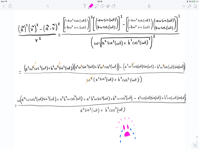

@ehild Sorry but I don't see what cancels, maybe I have the wrong terms for a and v? I attached my equation.
It is ω6 also in the second term. There is ω2 in a, ω in v, and av is squared. And you simplified by ω2 twice in the first term. Factor out the ω-s and simplify after.

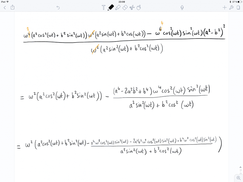

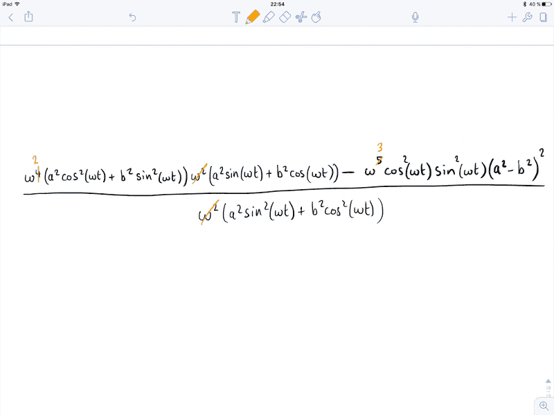

@ehild I corrected that but the equation still gets bigger and bigger without anything major canceling out really :/
  • Handwritten algebra on a tablet: a fraction with numerator ω^4(a^2cos^2(ωt)+b^2sin^2(ωt))ω^2(a^2sin(ωt)+b^2cos(ωt)) minus ω^6cos^2(ωt)sin^2(ωt)(a^2-b^2)^2, over denominator ω^2(a^2sin^2(ωt)+b^2cos^2(ωt)), with orange exponent marks, followed by two simplified lines.
Why did you divide the first term with the denominator? Just do the multiplication, and the square in the second term.
