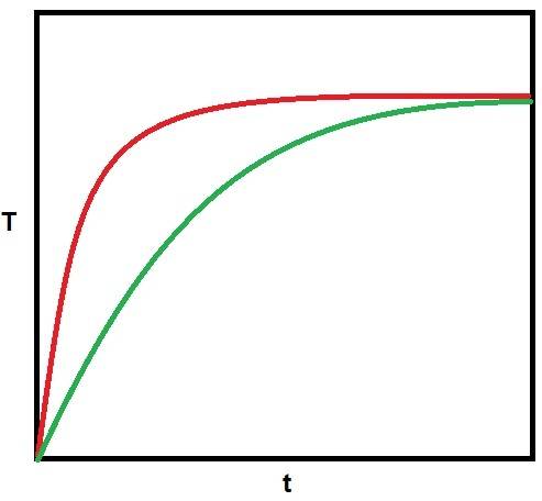

  • #51
Looks like you have a good handle on it. I'd enjoy seeing a graph of the complete solution to the differential equation as a function of time for a couple of cases.
  • #52
Something that I'm indeed trying to figure out. I merely concluded this since the next derivative of ##dT/dt## as well as ##dT/dt## itself are both proportional to the heat capacity.
I'm probably doing this the hard way but I would first want to solve the differential:
$$\frac{P_{in}-\epsilon \cdot \sigma \cdot A (T-T_{ambient})^4}{c \cdot m} = 0$$
To get ##T##. Which is in this case equal to:
$$T = (\frac{P_{in}}{\epsilon \cdot \sigma \cdot A})^{\frac{1}{4}} + T_{ambient}$$
After solving for T I'd then have to know the time until that ##T## is reached. The only formula so far that has a time parameter in it is the integral that I gave previously, so that:
$$\int_0^{Δt} \frac{P_{in} - \epsilon \cdot A \cdot σ(T-T_{ambient})^4}{c \cdot m} dt = (\frac{P_{in}}{\epsilon \cdot \sigma \cdot A})^{\frac{1}{4}}$$
However, I don't have any idea how to get ##Δt## out of this equation. Nor do I know what to fill in for ##T## in the intergral formula.
An alternative is maybe taking the next derivation of ##dT/dt## as a function of time, but that would only show the steepness of the decline without taking into account how high ##dT/dt## initially is at the start. It's very probable I'm doing this all the wrong way.

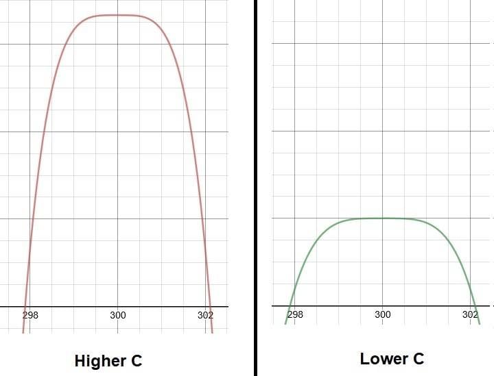

  • #53
I am no expert in differential equations, but I think it is likely that the exact and final ## T ## will not be reached in a finite time. In any case the function ## T(t) ## could be found by numerical methods (again of which I am no expert), and I think it might be the case that ## T(t) ## approaches its final value asymptotically but never quite gets there. ## \\ ## Editing... One thing you can do with this differential equation is write it in the form ## \frac{dT}{T^4-B}=dt ## and try to integrate both sides. I will need to study it further=I don't know that it has a closed form solution... Upon taking the difference of squares in the denominator and using partial fractions, perhaps it does have a closed form solution. Perhaps someone else can also comment on it. @fresh_42 Might this one have a closed form? ## \\ ## Editing... ## \int \frac{dx}{x^2+1}=tan^{-1}x ## and ## \int \frac{dx}{x+a}=ln|x+a| ## so I think a closed form might exist. If I get some extra time I may try to write out the complete solution... ## \\ ## Editing some more... It's likely to yield a complex expression for ## T(t) ## on one side of the equation that is equal to ## At ## on the other. The asymptotic solution will then be found by setting ## t=+\infty ## and the result will be that the term inside the natural log must be zero so that it also is equal to infinity. In this sense, I don't think this "closed form" solution will be of much help...
  • #54
Charles Link said:
I am no expert in differential equations, but I think it is likely that the exact and final TT T will not be reached in a finite time. In any case the function T(t)T(t) T(t) could be found by numerical methods (again of which I am no expert), and I think it might be the case that T(t)T(t) T(t) approaches its final value asymptotically but never quite gets there.
I think this explanation has made me notice my error in reasoning that time duration until thermal equilibrium doesn't change with lower heat capacities; it actually does.
The fact that a lower heat capacity gives a higher initial ##dT/dt## as well as a stronger decline in ##T##-increase over time (until thermal equilibrium has been reached) doesn't mean that a lower initial ##dT/dt## with a weak decline in ##T##-increase takes the same amount of time to reach thermal equilibrium. Even if ##dT/dt## and the steepness are both changed by the same factor.
When plotting the differential equation with 2 differen heat capacities (starting from T=300), this gives:
As shown, a higher heat capacity ##C## gives a high initial ##dT/dt## along with a rather abrupt decline in ##T##-increase, such that the temperature increase abruptly changes to a more or less horizontal line (the asymptote you mention) i.e. the thermal equilibrium.
A lower heat capacity ##C## has a lower initial ##dT/dt## and also a less abruptly declining ##T##-increase (the decline is less steep). Plotting temperature over time according to these descriptions gives:
Which obviously shows that it takes more time for the lower heat capacity to reach the same thermal equilibrium. Come to think of it, it's actually quite obvious. I guess I was focussing too much on the differential curves and taking way too farfetched conclusions.
I appreciate the effort you're taking with trying to prove this mathematically. Kind of feeling guilty now that I've drawn you into my confusion and trying to clear this up the hard way. :doh:
