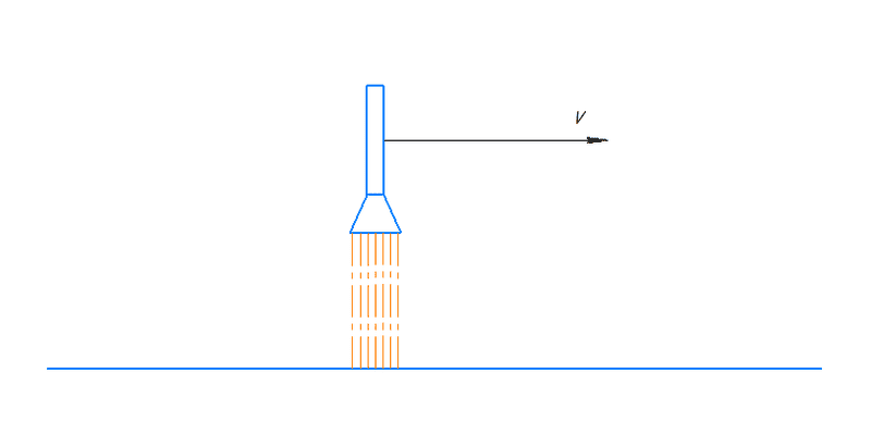

The discussion revolves around the concept of energy in different inertial reference frames, specifically examining a scenario involving a diesel electric generator and a load connected through an electric circuit. Participants explore the implications of special relativity, including time dilation and the relativity of simultaneity, in the context of energy production and consumption across moving frames.
  • Some participants question the validity of connecting reference frames through an electric circuit, asserting that reference frames are merely coordinate systems and not physical entities.
  • There is a discussion about the relativity of simultaneity and how it differs from the concept of time dilation, with some participants clarifying that clocks may not synchronize across different frames.
  • One participant suggests that the original setup described may be contradictory due to the differing power measurements in the respective rest frames of the generator and load.
  • Another participant proposes a modified scenario involving a laboratory and a moving capsule to clarify the relationship between the generator and load, while still emphasizing the conceptual disconnect in treating reference frames as physical connections.
  • Concerns are raised about the propagation speed of electrical signals, with some participants arguing that electrical signals do not travel at the speed of light, which complicates the analysis of the energy transfer between the generator and load.
  • One participant suggests rephrasing the problem using a light source and a photocell to simplify the analysis of energy transfer in a relativistic context.
Participants generally disagree on the interpretation of reference frames and their connection in the context of the problem. While some agree on the need to clarify the model, there is no consensus on the validity of the original scenario or the implications of relativistic effects on energy transfer.
Participants express uncertainty regarding the specifics of the motion of the capsule (straight line vs. circular) and how this affects the analysis. There are also unresolved questions about the simultaneous occurrence of processes in different frames and the implications for energy ratios.

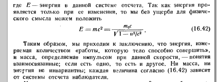

Excuse me if I misunderstand something, but in this book, on page 295, it literally says the following: "Since energy manifests itself only when it changes, we can put it without prejudice to the physical meaning.:
Thus, we come to the conclusion that energy, measured by the amount of "work that a body is capable of doing," and mass, determined by momentum at a given speed, are interrelated concepts. If there is one, then there is another. Neither mass nor energy are invariant; each quantity, according to (16.42), depends on the observer's frame of reference."

  • #32
It seems to me that the following conclusion can be drawn from this statement. If the energy depends on the reference frame, then the energy in the capsule (reference frame B) differs from what energy an observer in the laboratory identifies in it (reference frame A). If two reference frames are connected by a process occurring at the speed of light, which is equal for all reference frames, then the energy of the reference frame B can be obtained in the reference frame A...
  • #33
yes
The energy observed in reference frame B can be obtained by observations made in reference frame A if you know the relationships between the reference frames.
Also, the total energy observed in any reference frame is invariant (the same)*.
*In a non-expanding universe.
  • #34
DaveE said:
yes
That's the whole question. Is it true that being in the frame of reference A, we observe one amount of energy in the frame of reference B, and on the sliding contacts coming from the system B, we measure another amount of energy?
  • #35
Sorry, I don't know how to say this more simply.
  • #36
