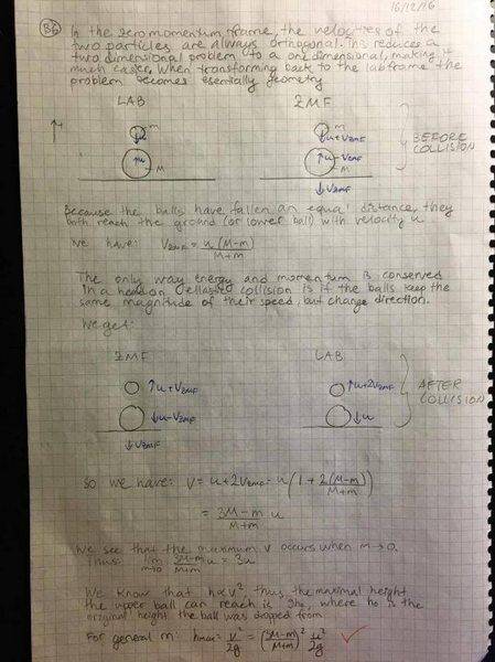

There are two elastic "superballs" of mass M and m placed on top of each other with a smal distance. The lighter ball of mass m is on top of the bigger ball of mass M. The balls are released from a height h and have velocity u when they hit the ground. Prove that the top ball will have velocity ## v = \frac{3M-m}{M+m} \cdot u ## when it leaves the bigger ball.

I didn't find it problematic to prove the requried result (see attached solution). What I find problematic is the result itself. I must have made some very silly misstake in my reasoning, but the end result I get is that the speed of the top ball after all collisions is ## u + 2v_{ZMF}## and of the bottom ball ##u##. However, before the two balls collide, they both had velocity ##u##. Clearly, energy conservation cannot be satisfied!
Can somebody please point out my probably very stupid misstake to me? Thank you! :)

Perhaps the big ball loses some speed when colliding with the smaller ball ? How did you find this ##u## for the bottom ball ?

Oh wait, I really messed it up! The speed of the big ball should be ## u - 2v_{ZMF}##, shouldn't it?

##mu + Mu = m(u + 2v_{ZMF}) + M\color{red}{V}##

Yes, and with that I think you will find the energy is conserved in the lab frame.

Yes. Thank you for helping me get it right! :)
