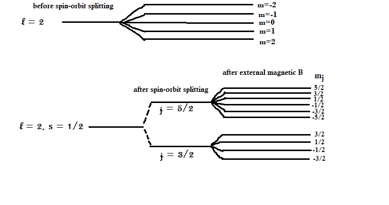

Sketch the energy diagram for a system with l = 2 and s = 1/2: before spin-orbit splitting, after spin-orbit splitting, after additional application of external magnetic B (label all m values).
m values from -l to l (total 2l+1 values)
j values from l-s to l+s
mj values from -j to j (total 2j+1 values)
I drew a diagram but I'm not sure if it's right. and before the spin-orbit splitting I was confused, so I just drew the m values for l (not sure though).

I don't think there would be any change in the energy level without B field. so I don't think I need to include the m values for l=2 without spin.. I have an example of the Zeeman effect but i don't really understand it. it shows arrows going down from the lines, do I need to draw a l=1 diagram if the energies go from D (l=2) to P state? I think the external B field would have a greater effect because it has more energy levels, the spin-orbit only has like 5 levels.
Technically the Zeeman effect is the fine splitting, in the presence of a magnetic field, of the spectral lines you get when there is no magnetic field. The arrows in your notes show the transitions that give rise to the spectra.

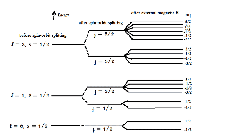

I made another drawing, don't have the arrows because I don't think I need it, would it be something like this? there are 5 levels now before the B field. I tried looking up zeeman effect but i was confused because it looked different from my problem.
You have decided that the spin-orbit splitting is bigger than the effect of the magnet?
You have decided that "a system with l=2" means to include l=0 and l=1 as well?
If so then you have got what you wanted.
These are decisions for you to make though, because it is your course.
