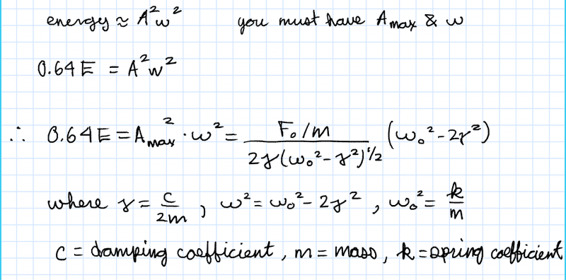

Find the driving frequencies at which the mechanical energy of the forced oscillation is 64 % of its maximum value. (Do not assume weak damping.)
E∝A2ω2, where A is amplitude & ω is the angular frequency.
Handwritten derivation: energy proportional to A squared omega squared; 0.64E = A squared omega squared; therefore 0.64E = A_max squared times omega squared, equal to F0/m over 2γ(ω0² − γ²)^½ times (ω0² − 2γ²), where γ = c/2m, ω² = ω0² − 2γ², ω0² = k/m; c is the damping coefficient, m the mass, k the spring coefficient.
Of course this problem is connected to a previous forced oscillator problem, where the values of c,m,k,& Fo are given. Here, I would like to know how to approach this problem and if the currents step I took are correct?
Thanks[/B]

No responses so far, so let me make a few comments:
Your problem statement is far from complete, so it's hard to guess what you are supposed to do.
Your relevant equations are incomplete too. Previous results (e.g. the ##A(\omega)## expression in the solution attempt seem to come out of the blue.
If ##E\propto A^2\omega^2## then ##E(\omega) = 0.64 \, E_{\rm max} \ \Leftrightarrow\ A\omega = 0.8 (A\omega)_{\rm max}##, and not ##0.64 \, E = A_{\rm max}^2\omega^2## (unless I miss something -- in which case I would like to see intermediate steps...)
Is that a start ?
