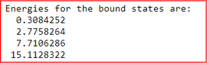

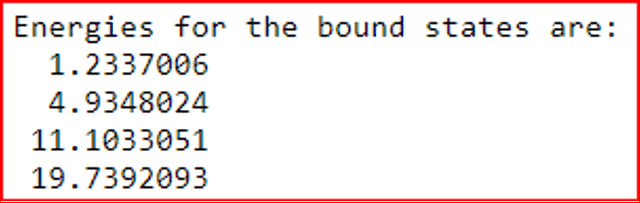

We find the odd solutions from a python code, for odd results Wave_function returns 𝜓(0) .
And for even results we look for solutions where 𝜓′(0)=0 by returning psi[-1,1] from Wave_function.
After getting these results we are supposed to compare them to the results we would get from by solving the equation in Griffiths?
E = [ (n^2) (pi^2) (h-bar^2) ] / [ 2 * m * a^2]
Here are the results from the python code:
Odd results:
Even results:
I tried to solve for energy using the equation:
I substituted the value for a as 4, as in the code the limit goes from -a to a, rather then 0 to a, and hence in the code a = 2, but for the equation it would equal to 4. However after trying various values of n, none of my results are close to the ones obtained in the equation.
What am Idoing wrong?
How would I get something similar to the values obtained from the code?

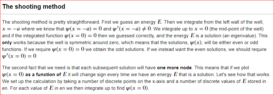

From the question:
we will be solving the infinite symmetric well using what is called the shooting method. The potential does not need to be a square well to use this method, but it is important that it is symmetric. To make the potential symmetric we define the potential from −𝑎−a to 𝑎a whereas Griffiths has it from 00 to 𝑎a. Furthermore, we shall use units where ℏ2/𝑚=1ℏ2/m=1.
Well, I'm not an expert at python, but after a lot of struggling I managed to get your results.
For the odd ##n## states it even prints nine 'energies' that rougly follow ##E_n = 0.353 \, n^2 ## where we expect ##E_n = 0.125 \, n^2 ##.
I didn't understand how $${\hbar ^2\over 2m} {\partial^2\over \partial x^2}\;\psi = (V-E)\;\psi $$ leads to
Python:
def D1D2(psi, x):
    D1 = psi[1] #First derivative
    D2 = 2.0*(V(x) - E)*psi[0] #Second derivative
    return array([D1, D2])
if ##{h^2\over 2m} = 1\;##. In other words: I miss a factor ##4\pi^2## ?
fumbled in the factor but didn't get the right answers yet:
Code:
Energies for the bound states are:
  0.0312500
  0.1250000
  0.2812500
  0.5000000
  0.7812500
  1.1250000
So a factor of 16 off from ##2 n^2\over 16##. Check normalization !
BvU said:
Any news ?
Sorry about the delay, i looked at what you said, and figured that when i was calculating the values i didnt factor h^2/2m as 1. but once i did so i got the same values as the code. and i got a perfect score as well. Thanks for the help.
