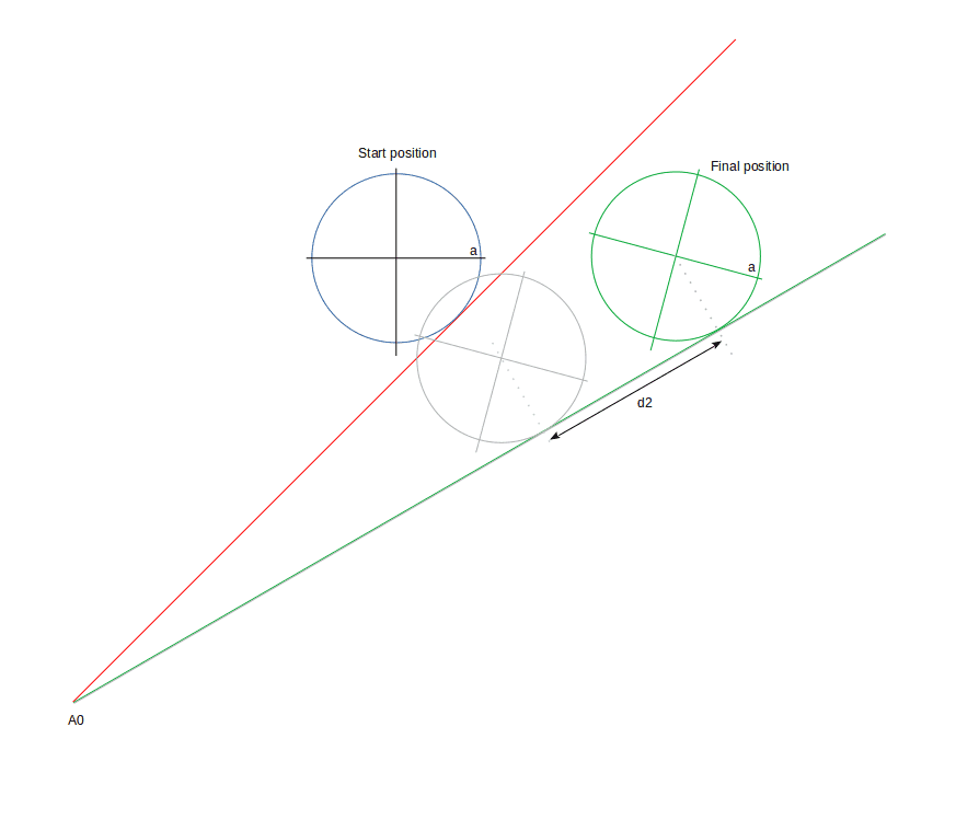

I use an example with a rack and a pinion. I suppose there is no losses from friction. I suppose the masses very low to simplify the study, and there is no acceleration. I suppose the tooth of the pinion and the rack perfect, I mean there is no gap. There is always the contact between the rack and the pinion, I mean the tooth are always in contact.
The device:
I drew 2 positions:
The distance lg equal to 131 mm.
Because the pinion tries to rotate faster there are the force F1 on the rack and the force F2 on the pinion:
I suppose the force F1 and F2 constant in value for the calculation, the value of F1 = the value of F2 = 1 N for example. The value of F1 is equal to the value of F2. The orientation of the forces F1 and F2 have the orientation of the red wall.
I used a geometric method to measure the distance of rotation needed for the pinion (around itself):
I measured d2=94 mm. So the energy needed to rotate the pinion is d2*F1 = 94*1= 94 J. The energy needed to move the pinion in translation is lg*(sin(pi/4)-sin(pi/6))/(pi/12) = 103 J.
So maybe the distance d2 is not like I think ? or the integral is not correct ?
I used a program to measured the length d2 and lg and the energies:

And the notations:
Are you trying to determine how the rack should be rotated so that the pinion is at fixed height?
kuruman said:
Are you trying to determine how the pinion should be rotated so that the wheel is at fixed height?
Yes, it is a part of the question. I'm not sure about the rotation of the pinion. But I'm not sure also in the calculation of the energies in translation and in rotation.

I noted ##i## the dot of intersection between the pinion and the rack, ##p## the dot of the center of the circle. I added ##x## and ##y## for easting/norhting and I added ##1## and ##2## to represent the last position ##2## and the new position ##1##. The radius of the pinion is ##R##. The height from ##A_0## to the top of the pinion is ##D##. The angle of the rack relatively to the horizontal is ##\alpha##.##i_{y2} = D-R-Rcos(\alpha_2)##
##i_{x2} = i_{y2}/tan(\alpha_2)##
##p_{x2} = i_{x2}-Rsin(\alpha_2)####i_{y1} = D-R-Rcos(\alpha_1)##
##i_{x1} = i_{y1}/tan(\alpha_1)##
##p_{x1} = i_{x1}-Rsin(\alpha_1)##
##d_2 = \sqrt{i_{x2}^2+i_{y2}^2} - \sqrt{i_{x1}^2+i_{y1}^2} ##
##d_1 = p_{x1} - p_{x2} ##
The energy from the translation is ##d_1 \int_{\frac{\pi}{4}}^{\frac{\pi}{6}} F cos(\alpha) d\alpha##
Numerical application : I take ##F_1=F_2=1 N##
##\alpha_2=45°##
##i_{y2} = 181.71##
##i_{x2} = 181.71##
##p_{x2} = 153.43##
##\alpha_1=30°##
##i_{y1} = 175.36##
##i_{x1} = 303.73##
##p_{x1} = 283.73##
##d_2 = 93.74##
##d_1 = 130.3##
The work from the rotation is ##F*d_2 = d_2 = 93.74##
The energy from the translation is ##d_1 \frac{\sin(\frac{\pi}{4}) - \sin(\frac{\pi}{6})}{\frac{\pi}{12}} = 0.791*130.3 = 103.08##
Maybe the energy from translation is more ##\int(10*(4*cos(x)-21)*csc(x)^2)*cos(x) dx## from ##\frac{pi}{4}## to ##\frac{pi}{6}## it is 104.2 J it is closer than the value I have with the program.

I need a little help there. From ##p_x = \frac{D-R-Rcos(\alpha)}{\tan(\alpha)}-Rsin(\alpha)## how to calculate the integration without pass from the derivative function ?
A.T. said:
Also, the rotation work is just angle * torque. No idea why you involve d2 there.
I used the length by the force (like I could move in translation the rack). But, it is the same result with the torque by the angle ##RF*135/180*\pi = 40*2.35*1 = 94##

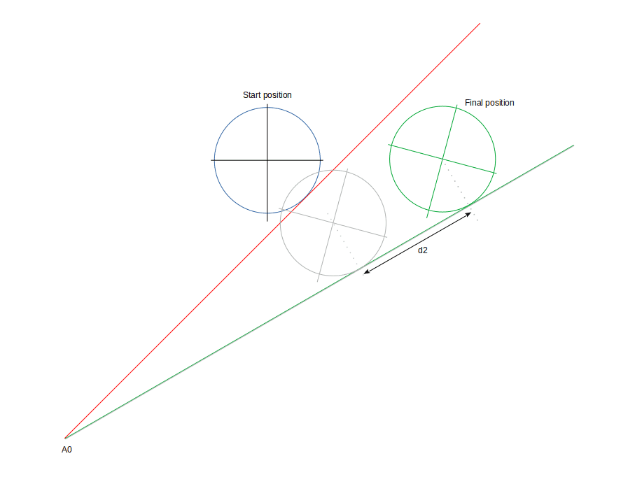

What I don't understand is why the angle labeled ##a## in your drawings would change. I assume that the pinion is powered by some energy source. It can only exert a force parallel to the rack with no perpendicular component and you show exactly that in your original post. What then would provide the necessary torque about the pivot to change the angular state of motion of the rack? Am I missing something?
kuruman said:
What I don't understand is why the angle labeled a
##a## is a fixed dot on the pinion. Torque about the pivot, you mean A0 ?
AT: in fact, I didn't think with a torque on the pinion, because it moves in translation, so I thought there is no energy needed/recover from the rotation of the pinion. The angle of rotation of the pinion is well near 150° not near 135° like I thought because I looked for the geometric transformation, in that case the work from the rotation is equal to the work of the translation. But it was not like that I thought. I can think with the energy recovered from the translation of the pinion and with the translation of the rack no ? Ok, it is not exactly what I explained, but why if I move the rack along the wall (the line I drew), the energy seems to be d2*F ? I mean why I cannot push the pinion, push the rack along the red line and let the pinion rotate itself ? it is a blockage ?
In that case, the final position is more like that (green color):
Look at the last drawing in post #1. Next to label A0 you have defined an angle ##a## with a double arrow. Obviously you think that this angle is changing because you indicate that it is in post #13. In an effort to understand this contraption and perhaps help you, I am asking you: what force generates the torque about A0 that is necessary to make this angle change? Is gravity acting conventionally from the top of the screen to the bottom? If so, you do not mention it anywhere.
kuruman said:
Look at the last drawing in post #1. Next to label A0 you have defined an angle with a double arrow.
Oh, yeah, sorry, the last drawing of the first message was for the notations of the program only but like in the program I can't use ##\alpha## in the program, so I used ##a##. I should have changed the name of the dot. No gravity here, and I think with masses very low. For me, ##a## is a dot fixed on the pinion to show the angle of rotation of the pinion.
AT: There are 2 manners to think. First, I translate the pinion and I rotate it, and the angle of rotation like I drew is well near of ##150°## so the energy recovered from the translation of the pinion is well the energy needed to rotate it: the program and the calculations are ok. Second method, I move the pinion in translation, I don't care about the rotation: I let him rotate like it wants and I move in translation the rack along the red line of the distance ##d_2##. The device that controls the pinion in translation applies a horizontal force (to the left) on the center of the pinion only. To move the rack along the red line I need an energy, and it seems that energy is lower. So maybe it is not possible to have that movement ?
The dot ##a## rotates like that in the second method :
I will ask you one last time. What causes the rack to rotate? You can calculate and simulate anything you want with your program but it will not correspond to a physical system unless it obeys the laws of physics.
What you have shown and explained so far indicates that the rack will not rotate about point A0; the final position of the pinion will not be as you show but farther away from A0 along a fixed rack. The green line and the red line will be on top of each other.
If the end of the rack at A0 is free to move, both the rack and the pinion will translate so as to keep their center of mass fixed in space. In this case the energy that goes in, presumably by a motor driving the pinion, will be split between the rack and the pinion.
If the end of the rack is not free to move, the rack will be fixed in space and the pinion will move away from the fixed end. In this case the energy goes entirely in the pinion.

Judging from the title of this thread, "Energy of translation compared to the energy of rotation", I thought OP is asking that. The title indicates a comparison of how much of the input energy goes into translational and how much into rotational energy. Without knowing the ratio of the masses, this comparison is meaningless.
Please, correct that: So the energy needed to rotate the pinion is d2*F1 = 94*1= 94 J. The energy recovered from the pinion in translation is lg*(sin(pi/4)-sin(pi/6))/(pi/12) = 103 J. That calculation is not correct, just approxiative, I corrected in the message to have the true calculation.
I would like to study with the mass as lower as possible, mass-less is perfect. And the energy-in must be equal to the energy-out.

But all is fine, because the circle rotates of near 150° not 135° like I thought. Look the message #21
