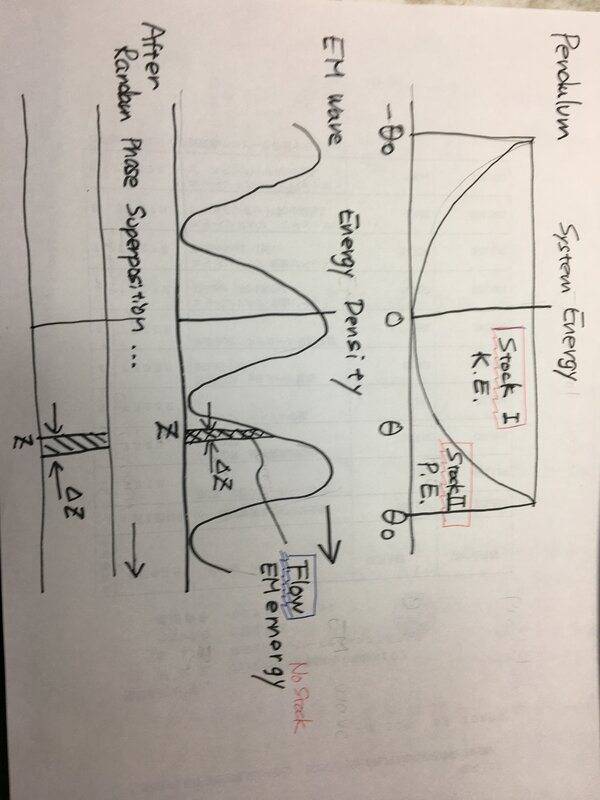

With your instruction now I distinguish the two cases :
Pendulum motion is a case of energy exchange between the two STOCKS (K.E and P.E.)
EM wave is a case of energy FLOW as you said above. I made a hand drawing to show my understanding.
Thanks.

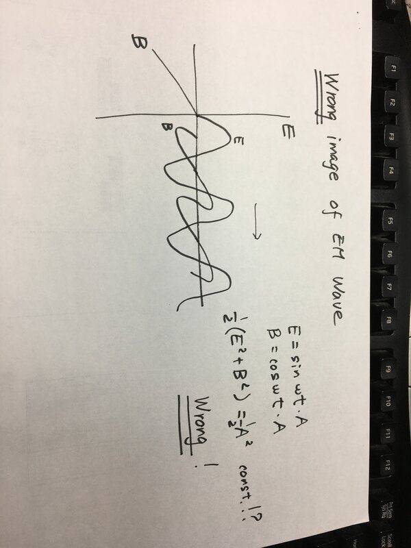

I retell my confusion in simpler case.
Energy of a harmonic oscillator
E_{ho}=\frac{1}{2}mv^2+\frac{1}{2}kx^2
and
vanhees71 said:
The energy density (!) of the electromagnetic field is (in Heaviside-Lorentz units)
u_{em}=\frac{1}{2}(E^2+B^2).
What's conserved is the total energy.
have similar mathematical form of ##A^2+B^2##. However
##E_{ho}## = time const. but ##u_{em}## of EM wave varies 0 < ##u_{em}## < max. depending on time.
I wrongly thought these two phenomena should behave similarly. Sorry for the confusion.

Thanks for explaining. That makes more sense now.
Note that they also have the same form as the Pythagorean theorem and I am sure many other similarly disconnected formulas. Merely having the same form does not always provide a clean analogy.
In this case one big difference is that ##E_{ho}## is the total energy, which is conserved, but ##u_{em}## is the energy density which is not conserved by itself.
To elaborate on that, I add that this stems from the difference in the sinusoidals that enter the two expressions. In the case of the pendulum, ##\theta(t)## and ##\dot \theta(t)## are multiplied by sinusoidals with a phase difference of ##\pi/2##; adding their squares gives a constant at any time time ##t## which is the mechanical energy that stays in the pendulum and changes form from potential to kinetic back and forth. In the case of the EM wave, the sinusoidals describing ##E(t)## and ##B(t)## are in phase; adding their squares gives another function of time which is time-averaged over a cycle to get the energy that is transferred by the wave across a surface without changing its form.

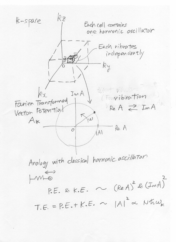

Re:post #9 I attached my preliminary understanding of harmonic oscillation interpretation of EM field. Any questions, corrections and teachings are appreciated.
Where the harmonic oscillators are ? In k-space. In each k cell lies an oscillator.
What vibrates ? Fourier transform of vector potential ##A_k##. Re##A_k##and Im##A_k## interchange with angular velocity ##\omega=ck##. P.E. & K.E. , total energy correspond to ##(Re\ A_k)^2## & ##(Im\ A_k)^2##, ##|A_k|^2##.
