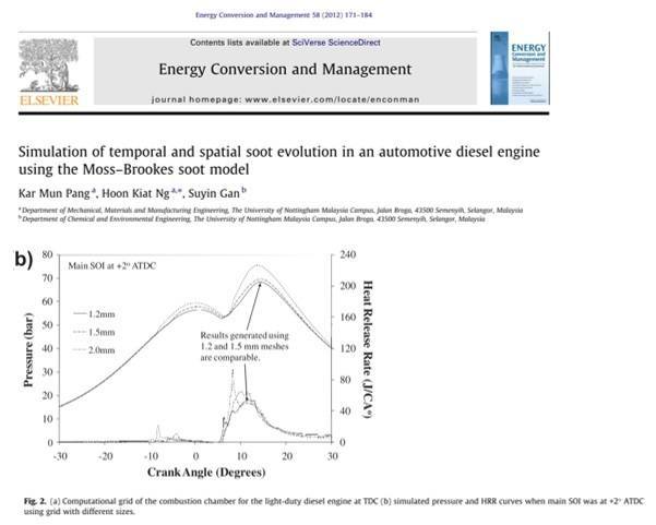

I'm not saying it's totally wrong, but based on my literature, all the references paper/journal reported that for crank angle between -150 degree to -50 degree, the in-cylinder pressure would be not more than 1 MPa. And also, by referring to my previous answer, most probably there is problem with the encoder which record all the crank angle data in my experiment. So maybe I need to verify this first.
I'm more inclined to believe your experimental data is accurate, since the simulation result seems surprisingly featureless, especially the lack of a pressure spike due to combustion. The experiment seems to agree fairly well in general shape with the plot from Mech_engineer, on the other hand. What kind of 2 stroke is it - is it a small 2 stroke? Large 2 stroke diesel? Turbocharged? Tuned exhaust?
It is a small 2 stroke with 85mm x 87mm (bore x stroke) without turbocharged or tuned exhaust
Do you have any examples in literature which show a similar simulated pressure curve to your result?
Here are 2 examples of articles with quite similar engine condition for comparison. Both showing low in-cylinder pressure (less than 1 MPa) in the earlier or later combustion process.
You should confirm that the encoder was reading your angular position correctly, but overall the "shape" of the curve seems reasonable. I agree that the pressure rise so early in the cylinder's travel seems suspicious, but if the encoder checks out maybe something else is happening...
