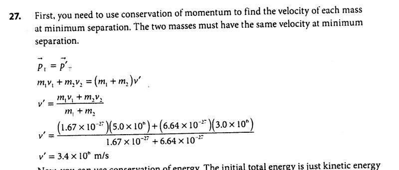

Yikes. I got access to the solution to this question and now I'm confused for a different reason.
Textbook solution to problem 27 showing the conservation of momentum step for v' = (m1v1 + m2v2)/(m1 + m2) with numerical values 1.67 x 10^-27 kg, 5.0 x 10^6 m/s, 6.64 x 10^-27 kg and 3.0 x 10^6 m/s, giving v' = 3.4 x 10^6 m/s.
I'm only supposed to take into account magnitude, not direction of velocity? I thought one of them would be negative, since they're moving in opposite directions.
You are correct, krbs. As you say, the direction of the velocity needs to be taken into account when calculating the momentum. So, one of the velocities should be negative. The solution shown in the attachment is incorrect.
