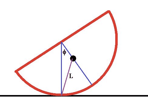

Why is it acceptable to choose an angle that doesn't coincide with a rotational arm?
I am looking at a textbook solution to the following problem of finding the equation of motion of a half disk. In the solution, the author considers the half disk has a COM at the black dot, and to find the instantaneous translational velocity of the center of mass (he considers rotational velocity about the COM separately) the solution uses the angle phi and the fact that the instantaneous center of rotation is the point of contact with the ground at a distance L. Thus the velocity of the COM is given as:
V_c = L*d(phi)/dt
I understand that the differential velocity of a ball at the end of a string as it is swung is v = R d(phi)/dt where d(phi) is the angle the ball travels at a radius R during some moment of time, as shown in the second image. But the angle phi in the first image (the book solution) is NOT the angle through which the COM rotates about the contact point. How can the above expression for the velocity of the COM be correct?

Thank you for replying! I do agree with you about generalized coordinates and their usefulness. However, I think you missed the point.
My question is specifically about how it can be correct to describe the translational velocity of the center of mass by using an angle that is not the angle traversed about the instantaneous center of rotation. See the second image I provided, wherein the velocity of a mass is put in terms both of the angle it traverses about the center of rotation and the distance from the center of rotation during the traversal. The first image (the contended solution) has the distance from the center of rotation (so that seems correct) but uses a completely different angle. As far as I can see, the angles are not the same at all, nor is the chosen angle related in any meaningful way to the distance L. Is the implication that we could use any old angle/distance pair to come up with a correct equation of motion? Or is the distance L fixed, inexplicably, and only the angle can be any angle we come up with to pair the distance to? Either choice makes no physical sense when considering the way it is usually taught (i.e., again, the second image where the angle is the angle traversed about the center of rotation and the distance is the distance of the mass from the center of rotation during the traversal.)
I hope that clears up the issue. With the given choice of angle, I do not understand why that rotational distance "pairs" with it to produce a physically meaningful velocity when the angle formed between the ground, contact point, and center of mass would seem more in line with the way it is taught.

Did you check to see whether ##V_c = L\frac{d\phi}{dt}## is correct?
Note that ##L## is a function of ##t##, so it's not immediately clear to me why you can write down the speed of the centre of mass as ##L\frac{d\phi}{dt}##.
But, if you calculate ##V_c## directly, it turns out to be precisely this. Sometimes you have to roll your sleeves up and do some calculations.

I am starting to think that they key to understanding why this works is that, for every choice of angle, the solution can only proceed once L is translated into an expression that is in terms of that angle. In this way, the product can be the same for many different angle choices without the time derivatives of different angles being the same. That may be what I have been missing in my own understanding: The solution will proceed only after L has been expressed in terms of constants (such as disk radius) and the chosen angle.

One thing you seem confused about. If I change the variables, I need to change them everywhere. For example, if [itex]L=a^4 + a^2[/itex], then [itex]dL/da = 4a^3 + 2a[/itex]. If [itex]b = a^2[/itex], I cannot say "no b's in that, so [itex]dL/db = 0[/itex]. I first need to replace the a's with b's and then take the derivative with respect to b. [itex]dL/db = 2b+ 1[/itex].
You will get different equations of motion in terms of a than in terms of b. As you should.
