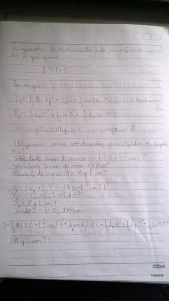

PaulaFrafa
Hi, my professor asked me to proove the equations of motion of a problem. The equations that I need to find are in page 2 of the file https://docs.google.com/file/d/0BxOdCfkh6FqpUlY5TktpbDZTc2M/edit , equations 7 and 8. But, I'm having trouble with the exercise.
I uploaded my attemps. Problably I'm wrinting a wrong Lagrangian.. Does anyone have a clue about the right way? Sorry for my english, I'm not a native speaker. Thanks
  • Handwritten notes deriving a Lagrangian: L = T - V, with kinetic energy terms for a mass M and a rod with angles theta and phi, and potential energy mgl cos theta terms.
  • Handwritten notes deriving Lagrange equations of motion, with Euler-Lagrange expressions d/dt(∂L/∂θ̇) − ∂L/∂θ and terms involving m, l, θ, φ, cos θ and sin θ.
Can you please write your equations in latex as per forum rules?
Than perhaps I will understand what you are asking, as the link provided leads me to a page that has no equations. (I couldn't turn the page.)
