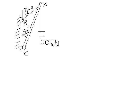

A 100-kg mass is suspended by a boom hinged to the wall at one end and tied to the wall at the other end by a cable.Determine the tension in cable AB and the axial force in boom AC.
Could you please give me a detailed explanation of how to do this and the answer. Thanks
To get help, show us what you've done so far. (Hint: What are the rotational and translational conditions for equilibrium?)
equilibrium of coplaner forces systems
My professor gave us this for homework and has not really gone over it yet.
The answer is in the book but I really need to know how to work the problem.
I think you may multiply 100 kN by 9.8m/s, but besides that i have no clue what to do. The answer in the back of the book is Tension AB=1430 N
and F AC=2200 N. I worked on this problem for a while but that is all i can figure out to do.
Thanks for your help.

Ok, here's the methodology. A little hard to tell from the picture, but I assume B and C are pinned joints (i.e. can't support a moment) and A is a frictionless pulley (same thing, can't support a moment)
1. Draw each member (AB, BC, AC) separately without touching each other. In other words, explode the picture apart keeping the orientation of each member intact
2. At the ends of each member, draw forces in x and y directions and label them F1, F2, F3, etc. It doesn't matter which direction (+ or -) you place each force, as the correct direction will come out of the equations. Hint: at point A, you already know the magnitude and direction of the vertical force
3. In each coordinate direction (x,y), create an algebraic equation summing the forces. The sum must equal zero. You'll end up with 2 equations in the form of F1 - F3 + F6 + ... = 0
4. For moments, pick a point (A, B, or C) and write the moment equations about that point, making sure to properly keep track of the direction of the moment. You'll need the geometry to calculate the moment arms. I presume you know at least one of the distances AB, BC, CD. It is pure trig to find the moment arms. The moment equation also must equal zero. It will be in the form of F1*d1 - F2*d2 + ... = 0, where F's are the forces you labeled in step 2 and d's are the moment arms you calculate from the geometry.
5. In general, you'll end up with n equations in n unknowns, the unknowns being the F's. You may need to write moment equations at additional points if you don't have enough equations.
6. Solve the equations for the F's by combining equations to eliminate some of the unknowns and by substitution (system of linear equations).
This is tedious work, but straightforward. It is critical that you keep consistent with +/- directions for the F's.

Hi! In solving this problem, I believe you need to make an important assumption: that the boom is massless...
Also, you will need to come to the realization that there are actually 2 pieces of cable present here, so the tension in the cable AB may not be equal to the tension in the vertical cable (which is connected to the 100 kg mass).
Now the tension in the vertical cable can be found very easily. Since the 100 kg mass is in equilibrium, how is the tension in the vertical cable related to the weight of the mass?
Knowing that, you can begin...
1) Generally, for an equilibrium question, we can choose to take moments about a point or resolve forces in 2 perpendicular directions. We normally start by taking moments, as this enables us to eliminate some of the forces. For example, if we take moments about a point, and a force passes exactly through that point, the moment exerted by the force about that point is zero. So now, let us consider the forces acting on the boom. About which point should you take moments so that you can determine the tension in cable AB? Remember, the only force whose magnitude you know is the tension in the vertical cable...
2) Once you have determined the tensional forces in both cables, you can proceed to find the axial force in boom AC. Resolve forces vertically and horizontally, then calculate the horizontal and vertical components of the axial force. Finally, use Pythagoras' Theorem to calculate the actual value of this force... This step may involve numbers with many decimal places, but do not give up! Equilibrium questions normally involve non-exact numbers due to the involvement of trigonometry.
