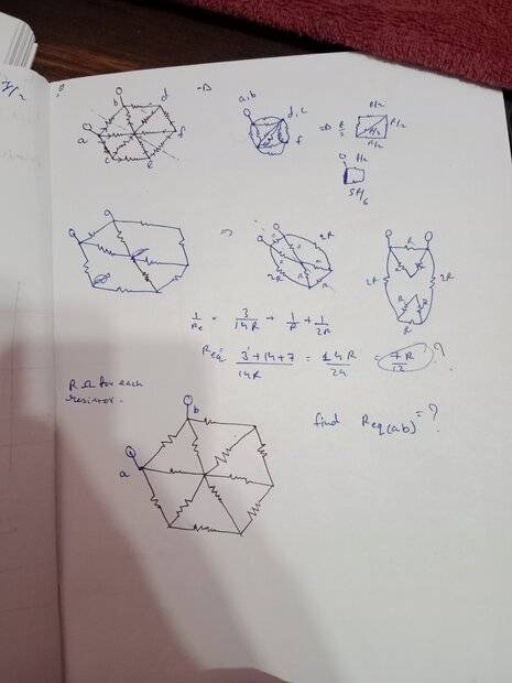

Each resistor has resistance R, find R equivalent b/w ab

You need to use symmetry arguments to simplify the circuit.
E.g. consider the two resistors connecting a and b to the middle node. What can you say about the currents through them?
I know mirror symmetry not sure which resistor to remove
I didn't say to remove any, yet. I asked what you can say about the relationship between the currents in the two resistors connecting a and b to the centre.

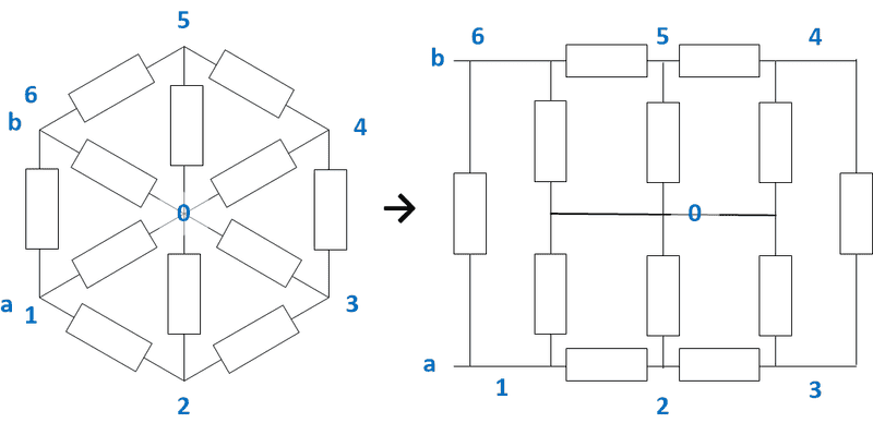

Yes, you can cut the central node into two, one that connects the pair of resistors we've been discussing and one that connects the other four radial ones.
Can you apply the same trick again?

Can you be clearer? Number the nodes 1 to 6 anticlockwise around the hexagon starting with 1 at a. Call the centre 0.
We have split 0 into ##0_{16}## and ##0_{2345}##. What next?

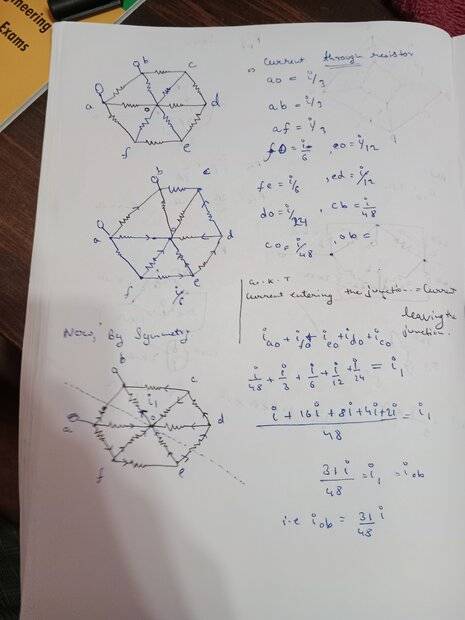

Ok even if I don't take it out the current in 05 is same as that in 04 so even if I take 045 out(i.e. then simplify it in grid ) , the resistance might be the same as I calculated
I do not see why that should be.
Since we took 016 out, current goes to 20 and also from 30 but from 20 and 30 the current had two paths only, so current must divide equally
Sorry, I have no idea what you mean by "current goes to 20". There is no node called 20. There is a resistor we can call 20, but current goes through a resistor, not to it.
Please try to be clearer.
I meant current flowing through node 2 to node 0 through resistor 2-0
Ok, so what did you mean by the current dividing equally? Between where and where, and using what symmetry?
It has to divide equally since, maybe cuz it can't go anywhere else
