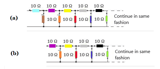

Calculate the equivalent resistance. Is it possible to calculate an exact value?
Series: R1+R2+R3....Rn = Req
Parallel: (1/Req)=(1/R1)+(1/R2)…(1/Rn)
I start from far right:
Green and blue are parallel Connection:
This in turn is in series connection with black resistor:
and so on ...
This is what I'm ending up with
My final equivalent resistance is (275/17) Ω. Is this correct?

What about the black resistor? Either this was a simple oversight, or you need to review what parallel resistors are.
Also, take note that this circuit goes on forever to the right side. There is no "right most" resistor. You said you started at the right; I think you started somewhere in the middle.
Oh right, I get it now. So I will never be able to calculate an exact value because the Circuit is never ending. Maybe I should start from the left and work my way up to at least five more parallel resitors just to show that.
Actually, you can calculate the exact value. There is a trick to getting the answer that might be hard to see if you've never seen the trick before! It's also hard to give a hint without giving the whole thing away. :oldfrown:
You are interested in the total resistance of the network shown in figure (a) below:
Consider the part of this network that is to the right of the brown resistor, as shown in (b).
You can model all of the stuff to the right of some arbitrary point as a single resistor of (initially) unknown value. Then look for patterns. It's sort of like the infinite series calculations that you may have seen in your math classes.

The equivalent resistance for orange and red:
The equivalent resistance for 5Ω-resistor and Purple:
5Ω+10Ω = 15Ω
The equivalent resistance for 15Ω-resistor and blue:
The equivalent resistance for 6Ω-resistor and yellow:
6Ω+10Ω=16Ω
The equivalent resistance for 16Ω-resistor and green:
The equivalent resistance for 80/13Ω-resistor and gray:
The equivalent resistance for 210/13Ω-resistor and black:
If this calculation is correct , do you mean that this pattern will repeat itself?
As @DaveE pointed out earlier, the orange and red resistors are not in parallel due to the yellow resistor between them. So, you cannot combine them to get 5Ω equivalence.
Going back to the picture in post #5, how does the total resistance of figure (b) compare to the total resistance of figure (a)?

Then purple must be in series with orange, yellow with red, grey with blue and finally black with green, or is it wrong?
VitaminK said:
I guess the total resistance in figure b is less than a?
Can you find any difference in the networks of (a) and (b)? [Other than the colors! :smile: ]
None of the individual resistors in the network are in series or parallel.
Perhaps it would help if you first solve the finite circuit that only has the left-most 4 resistors. Then solve it for the left-most 6 resistors, then 8 ... Look for a pattern. How does adding 2 more resistors to the previously solved version change the answer?
Less than 2 is a good guess. I really don't want to give it away @VitaminK . If you can arrive at the method of solving with just a little prompting, it will help your problem solving skills, because you'll probably remember it better.
two resistors less
scottdave said:
So using that information, you could solve for an actual value of x.
Now how can you apply that thinking to the resistors. Is there a portion of the whole network, which looks like the whole network. Then we can go about solving for the value of "X" resistance.
I guess that would be the resistors in b)
Yes
something like this?
If R is the unknown equivalent resistance of (a), what is the equivalent resistance of (b)?
It's R
VitaminK said:
It's R
Yes. Can you redraw network (a) so that it takes this into account and becomes a simpler network?
like this?
VitaminK said:
Well, this is a correct drawing. But it is not what I had in mind. Make use of the fact that (a) and (b) have the same resistance R.
VitaminK said:
No. This is not correct. It will probably help if you explain in words how you got this incorrect diagram.
I've now replaced circuit b) with R.
VitaminK said:
View attachment 258304I've now replaced circuit b) with R.
So find an expression for the resistance of this circuit (leaving in the variable R). Then, as you figured out, this circuit has the same resistance as the one you drew in post #25.
