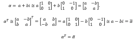

Thanks, Gavran, but apparently I did not express myself very well. Let me try again. First, if I understand your post correctly (but probably I am not), it seems that in Post #8, that you are stating
Then, however, suppose we take the complex conjugate of both sides , then we get
where α is the Hermitian adjoint of α.
Alternatively, suppose we take the transpose of the same both sides, then we get
The problem is that in general
This discrepancy leads me to agree with the earlier answers that one should be careful with the word "isomorphism" here. The correspondence you propose in post #8 does not respect transpose, so the above equations with ≅ would not be correct.
("Would" because I am probably misunderstanding your post. I am happy to be corrected.)

The transposition of a complex number is the same complex number, and the conjugation of a real matrix is the same real matrix. It is obvious that the transposition of a complex number corresponds to the conjugation of its 2×2 matrix representation.
## \alpha^T\cong\begin{pmatrix}a&-b\\b&a\end{pmatrix}^T ## at the beginning of the second line above does not hold, and ## \alpha^T ## is not equal to ## \bar{\alpha} ##.
Thanks very much, Gavron! I see my error now. I had not rid myself of my prejudice that isomorphism preserved all structures; I understand now that isomorphism only preserves the specific operations that define the structure in question, but that "transpose" is an additional structure. This helps a lot!
