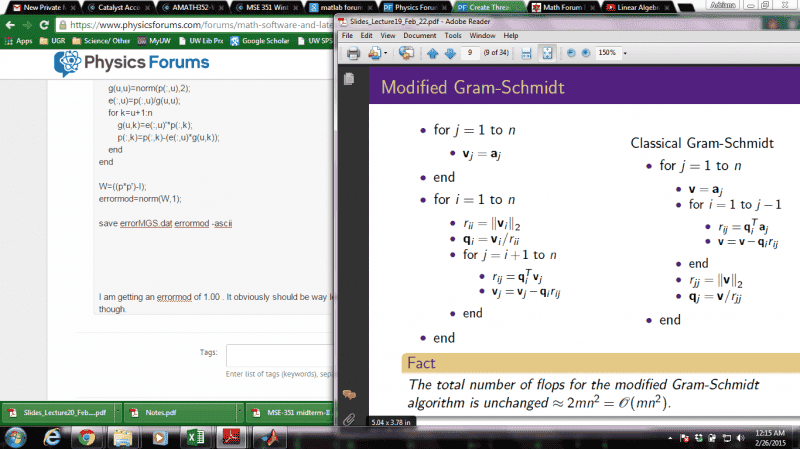

I am to compute A = QR using the Modified Gram-Schmidt algorithm. I need to find the error using
the one norm of : (Q transpose * Q) - I.
Here is my code:

I am getting an errormod of 1.00 . It obviously should be way less than this. I can't see what I am doing wrong, though. I modeled my code after an example proided by my prof: (The left part of the powerpoint)
Any help is appreciated!
Reading through your code, it looks like you are saving the p as the full-scale matrix, where e is the normalized matrix.
Try setting p(:,u)=e(:.u) at the end of the loop for each u.
