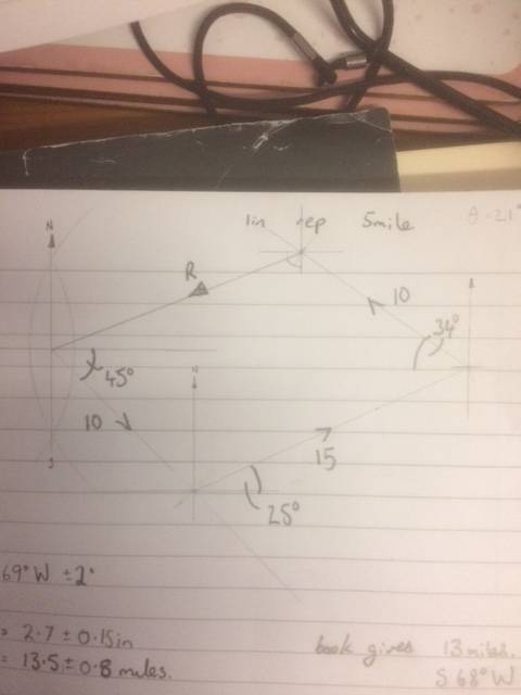

The question from an O level maths text is quite simple and involves scale drawing to obtain a solution. It is written as follows:
An aeroplane flies 10 miles SE, 15 miles E 25 deg N then 10 miles N 56 deg W. Construct a scale drawing and find the distance and direction in which the aircraft must now fly to return to its starting-point.
Before I completed the drawing I completed a quick freehand sketch, resolved the vectors in a north and east orientation and calculated the resultant vector and compass bearing, see attachment 253.
My results gave the following:
distance 13.3 miles
bearing S 68.6 deg W
I then decided on the following scale: 1 inch represents 5 mile (my ruler is graduated in inches and tenths). I then thought that the uncertainty in the length of any line I drew was +/- 0.1 inches (this seemed rather a lot to me but I had previously heard that one should measure to the nearest small graduation and half that value, 0.05 inches, would be your error at that end of the ruler; however, as there are two ends to consider the total error per line drawn would be 0.1 inches.)
I then looked at my sketch and the thought occurred to me that I couldn't just sum these errors as they are in different directions, see attachment 252. My thought was to resolve the errors, in the same way I had the vectors to obtain t
wo perpendicular errors then us Pythagoras' Theorem to give the resultant error, see attachment 254.
My scale drawing and calculated errors gave distance of 13 +/- 1.5 miles and a bearing of S 69 deg W +/-3 deg. The range of both agree with calculated answer. Furthermore, solution in text (also probably found by scale drawing) gives 13 miles and S 68 deg W.
If you are trying to measure an existing distance then you will align one end with a gradation. The error in the measurement at that end depends only on how precisely you do that (parallax etc.); the error at the other end will be ± half a gradation.
But if you are trying to draw a new length which should be a whole number of gradations then you only have your own precision to worry about at each end.
Quite so, and you also need to think about errors in the angles. Each point you construct will have an area of error. A long distance amplifies the angle error, so the area might be a lot wider in the transverse direction than in the longitudinal direction.
