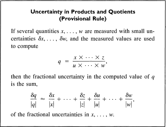

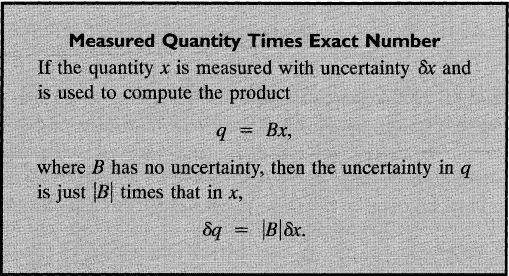

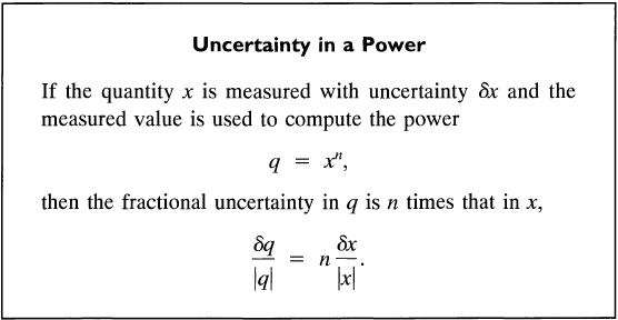

I'm reading "An Introduction to Error Analysis" by John R Taylor during my spring vacation as brush up for my next semester. I encountered an example that doesn't make sense to me though. It goes through teaching 3 rules as follows:
(3.8)
(3.9)
(3.10)

$$\frac{\delta g}{g}=\frac{\delta h}{h}+2*\frac{\delta t}{t} = 0.007+2*0.063 = 0.133$$
as justifed by 3.8 and 3.10. However here is my problem; What about 3.9?
As far as I can see, the example completely forgets about the factor 2. With 3.9 in mind, ##x = \frac{h}{t^2}## shouldn't it be:
$$\frac{\delta g}{g}=2*\left(\frac{\delta h}{h}+2*\frac{\delta t}{t}\right)$$
What am I missing?

Honestly, you should not be using 3.8 because it essentially makes the assumption that all the errors are correlated (which may be conservative, but usually not the case). If the errors are uncorrelated, it would be more appropriate to add the relative errors in quadrature.
However, given 3.8-10: No, there should not be a factor of 2. What is given in 3.9 is ##\delta q##, not ##\delta q/q##. The factor of 2 from ##\delta q## cancels the factor of 2 from ##q##.
Edit: To expand on that, 3.9 states ##\delta q = |B| \delta x## and by definition ##|q| = |B| |x|## and therefore
\frac{\delta q}{|q|} = \frac{|B|\delta x}{|B| |x|} = \frac{\delta x}{|x|}.
Also, do not write ##\delta * x##, it is ##\delta x## which is the error in ##x##. The ##\delta## and the ##x## are part of the same symbol representing the error in ##x##.

Of course! Embarrassing oversight on my part. Thanks a bunch!
