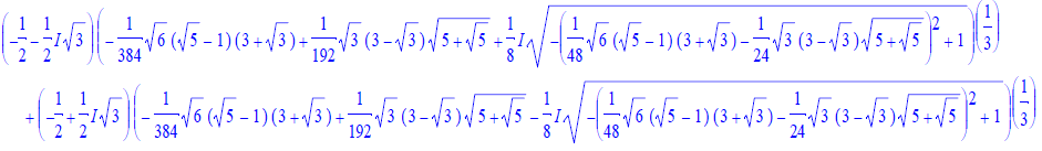

Instead of repeatedly complaining what you think you would get, why don't you actually do the calculation and see what you really get?
You can get the answer with Wolfram alpha if you enter -4 * x ^3 + 3 * x = sin(pi/60) and click "exact expressions". There will be complex numbers in the expression. -4 * x ^3 + 3 * x = sin(pi/60) has 3 real roots, and you need to use the complex roots of a complex number in this case to get the real roots. See https://en.wikipedia.org/wiki/Casus_irreducibilis
