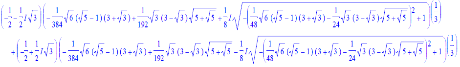

from this page (intmath.com), a solution that include the cube roots of complex numbers:
Long Mathematica-style expression with cube roots, containing nested square roots of sqrt(5), sqrt(3) and sqrt(6), and complex unit I, forming an exact closed form for sine of 1 degree.
A comprehensive list is available here: Exact value from sine 1° to sine 90°
.Scott said:
Yes, but my view is that this is not really the solution I sought. There is one real root which must be the Sine of 1° but expressing it in a closed form without roots of complex numbers or Sines and Cosines of other angles which was the original intent of the post, is not possible
