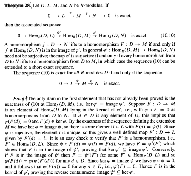

I am reading Dummit and Foote, Chapter 10, Section 10.5, Exact Sequences - Projective, Injective and Flat Modules.
I need help with a minor step of D&F, Chapter 10, Theorem 28 on liftings of homomorphisms.
In the proof of the first part of the theorem (see image below) D&F make the following statement:
Conversely, if F is in the image of [itex]\psi'[/itex] then [itex]F = \psi' (F')[/itex] for some [itex]F' \in Hom_R (D, L)[/itex] and so [itex]\phi ( F (d) )) = \phi ( \psi ( F' (d)))[/itex] for any [itex]d \in D[/itex]. ...
My problem is that surely [itex]F = \psi' (F')[/itex] implies that [itex]\phi ( F (d) )) = \phi ( \psi' ( F' (d)))[/itex] and NOT [itex]\phi ( F (d) )) = \phi ( \psi ( F' (d)))[/itex]?
Hoping someone can help>
Theorem 28 and the first part of the proof read as follows:
This cannot be true. We know that ##F^\prime\in \textrm{Hom}(D,L)##, and thus ##F^\prime(d)\in L##. But the domain of ##\psi^\prime## is not ##L##, but rather ##\textrm{Hom}(D,L)##. So ##\psi^\prime(F^\prime(d))## makes no sense since ##F^\prime(d)## is not in the domain of ##\psi^\prime##.

Problem 1 ... to get [itex]\phi ( F (d) )) = \phi ( \psi' ( F' (d)))[/itex] I simply replaced the [itex]F[/itex] with [itex]\psi' (F')[/itex] since we have that [itex]F = \psi' (F')[/itex] ... but presumably I did something 'illegal' ... can you explain my error?
Problem 2 ... How then does it follow that [itex]\phi ( F (d) )) = \phi ( \psi ( F' (d)))[/itex] for any [itex]d \in D[/itex] (given that [itex]F = \psi' (F')[/itex]? Can you help?
If you simply substituted, then you would have gotten
[tex]F(d) = \psi^\prime(F^\prime)(d)[/tex]
Thus ##\psi^\prime(F^\prime)## acts on ##d##. You would not get [tex]F(d) = \psi^\prime(F^\prime(d))[/tex]
Now, by definition, we have ##\psi^\prime(F^\prime) = \psi\circ F^\prime##. Thus
[tex]F(d) = \psi^\prime(F^\prime)(d) = (\psi\circ F^\prime)(d) = \psi(F^\prime(d))[/tex]

Thanks ... appreciate your help ... given me the confidence to go forward from there in my attempt to understand projective modules
