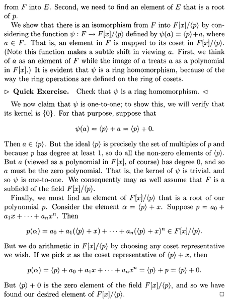

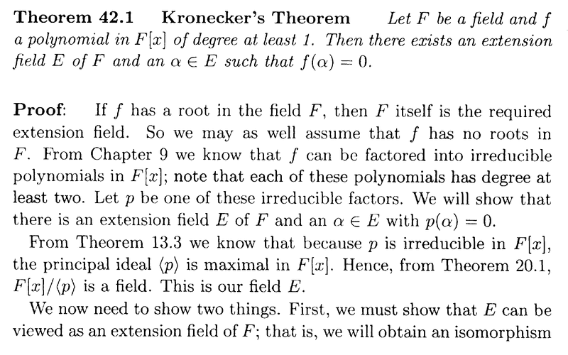

I am reading Anderson and Feil - A First Course in Abstract Algebra.
I am currently focused on Ch. 42: Field Extensions and Kronecker's Theorem ...
I need some help with an aspect of the proof of Theorem 42.1 ( Kronecker's Theorem) ...
Theorem 42.1 and its proof read as follows:
In the above text by Anderson and Feil we read the following:
" ... ... We show that there is an isomorphism from ##F## into ##F[x] / <p>## by considering the function ##\psi \ : \ F \longrightarrow F[x] / <p>## defined by ##\psi (a) = <p> + a##, where ##a \in F##. ... ... "Te authors show that ##\psi## is one-to-one or injective but do not show that ##\psi## is onto or surjective ...
My question is ... how do we know that ##\psi## is surjective ...
... for example if a polynomial in ##F[x]##, say ##f##, is degree 5, and ##p## is degree 3 then dividing ##f## by ##p## gives a polynomial remainder ##r## of degree 2 ... then ##r + <p>## will not be of the form ##<p> + a## where ##a \in F## ... ... and so it seems that ##\psi## is not surjective ... since the coset of ##f## is not of the form ##<p> + a## where ##a \in F## ...
... ?Obviously my thinking is somehow mistaken ...... can anyone help by demonstrating that ##\psi## is surjective ... and hence (given that Anderson and Feil have demonstrated it is injective) an isomorphism ...Help will be appreciated ...

As I read the text, ##\psi## is a isomorphism from ##F## into ##E = F[x]/<p>##, not onto ##E##. We don't want ##F## to be isomorphic to all of ##E## because ##E## is supposed to be an extension field of ##F## that contains an element not in ##F##.

##\psi## is not surjective. ##F \hookrightarrow F[x]/\langle p(x) \rangle## is a proper embedding for otherwise ##p(x)## would have to be linear.
The notation "##\psi## maps ##F## isomorphic into ##F[x]/\langle p(x) \rangle##" is a bit sloppy for "##\psi## maps ##F## isomorphic onto its image in ##F[x]/\langle p(x) \rangle##", i.e. is a monomorphism, an injective homomorphism.

Thanks Andrew ...You write ...
" ... ... I don't quite see why you are dividing ##f## by ##p##. ..."
Well ... we have that ##f, p \in F[x]## with ##f## being of degree 5 and ##p## of degree 3 ...
Suppose after polynomial division we have ##f = qp + r## ... then I'm assuming that the coset of ##f## in ##F[x]## is ##r + <p>## .. ... and ##r## may well be a degree 2 polynomial (depending on the division) and hence not equal to any ##a \in F## (that is a zero degree polynomial in F[x] ...)
Hope my meaning is now clear ... let me know what you think ...
I am now thinking that ##\psi## is not an isomorphism ... see Stephen's post ... I read the theorem rather carelessly ... :frown:
Peter
Thanks to fresh_42 and to Stephen for clarifying the matter ... I appreciate your help ...
Peter
