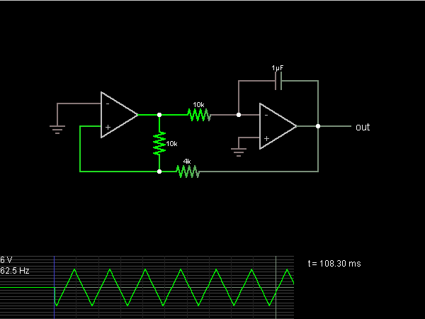

example of a varible capacitor input op-amp to voltage level circuit.
I'm not sure how to turn reactance to a voltage level using an op-amp? :wink:
maybe you could try to explain what you are doing in the initial post. What capacitance range, what accuracy, how fast to respond, what voltage range, etc.
First read up on "how to build a capacitance meter" or "measure capacitance" to get some ideas. Measuring capacitance requires a time or frequency based solution.
a capacitive probe being measured by a resistive ladder adc. 0-5 volt range, response time not important, 10 bit accuracy but the increments will be determined by the probes range which is unknown.

One could apply direct current and measure rate of voltage rise, or measure voltage after known charge has accumulated,
or apply voltage with known dv/dt and measure current,
this circuit's period of oscillation will be in proportion to capacitance... and slope inversely so.
One could perhaps follow it with a differentiator and precision rectifier to arrive at inverse of C...
