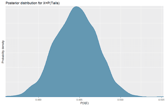

Posterior probability for coin flip example
Overall the data has 19783 Tails, so we would not agree with a hypothesis that ##X \approx 0.6## but we would be willing to accept a hypothesis that ##X \approx 0.495##. In fact, for any ##X##, we can estimate ##P(X|E)## and thus get our posterior distribution.
post <- stan_glm(End ~ 1, data = dat, family = binomial(link = "logit"))
mcmc_dens(post, transformations = inv_logit) +
labs(title = "Posterior distribution for X=P(Tails)", x = "P(X|E)", y = "Probability density")
From this it looks like with 40000 flips we have a fairly precise estimate of the probability of getting Tails, which is in the range 0.49 to 0.50. To be more exact, we can calculate the Highest Posterior Density (HPD) interval which is the smallest interval such that ##P(X\in [HPD] | E)=0.95##.
summary(emmeans(post, specs = ~ 1, type = "response"))
Gives us
1        prob lower.HPD upper.HPD
overall 0.495      0.49     0.499
Results are back-transformed from the logit scale
HPD interval probability: 0.95
So the HPD is [0.490,0.499] and notably 0.5 is outside of the HPD. To misuse frequentist terminology, would imply that the coin is significantly unfair.
But with a Bayesian posterior, we can do more than just calculate the HPD. For example, with the practical equivalence criteria described above, we can calculate ##P(X \in [0.49,0.51]|E) = 0.969##. Meaning that even though the coin is probably not exactly fair it is also probably close enough to fair to be considered equivalent for all practical purposes. The calculation is as follows:
post.df <- as.data.frame(post)
post.df$ptails <- inv_logit(post.df$`(Intercept)`)
ecdf(post.df$ptails)(0.51)-ecdf(post.df$ptails)(0.49)

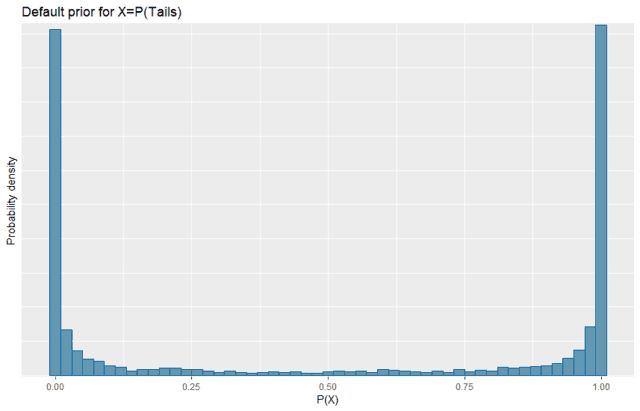

Default prior
In this case the default prior is a normal distribution for the log of the odds of X ##\log(O(X))=\mathcal{N}(\mu=0,\sigma=10)##. Because of the transformation, it is not clear what that means. So we can do the following
prior.default <- stan_glm(End ~ 1, data = dat, family = binomial(link = "logit"),
prior_PD = TRUE)
prior_summary(prior.default)
mcmc_hist(prior.default, transformations = inv_logit, binwidth = 0.02) +
expand_limits(x=c(0.0,1.0)) +
labs(title = "Default prior for X=P(Tails)", x = "P(X)", y = "Probability density")
Default prior
Note that, because of the transformation, this default prior looks substantially different from what we might expect or want. This specifies that, without seeing the data, we believe that the coin is probably either going to give all heads or all tails with it being very unlikely to be a fair coin.

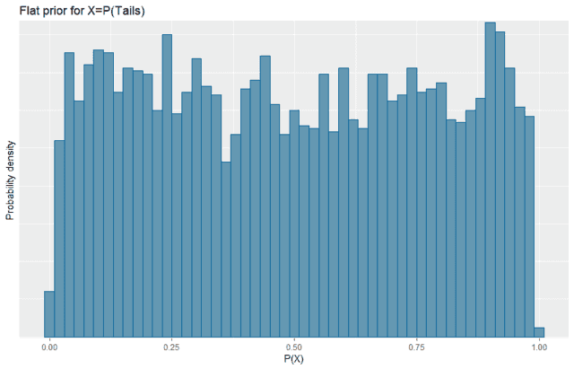

Flat prior
So, let’s change our prior to ##\log(O(X))=\mathcal{N}(\mu=0,\sigma=1.7)## using the following code:
prior.flat <- stan_glm(End ~ 1, data = dat, family = binomial(link = "logit"),
prior_PD = TRUE, prior_intercept = normal(0,1.7))
prior_summary(prior.flat)
mcmc_hist(prior.flat, transformations = inv_logit, binwidth = 0.02)+
labs(title = "Flat prior for X=P(Tails)", x = "P(X)", y = "Probability density")
Flat prior
Note that we now have a much more even distribution across the range. This is what we would typically think of as an uninformative prior for this problem. All values of ##P(Tails)## are possible and roughly uniform probability.

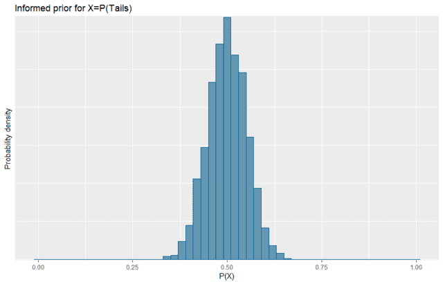

Informed prior
Now, realistically, we have seen coins in the past and have a decent amount of experience with them. For this study we were given that the coin is a standard US dime, so we know that it is not some trick novelty coin. In our experience, a standard coin might be slightly unfair, but it is close enough to fair that we have not noticed anything despite a lifetime of using such coins.
So let’s choose a prior that reflects that, but is also not overly specific since it is indeed possible that there is some small unfairness that we simply haven’t noticed because we didn’t flip one 40000 times. ##\log(O(X))=\mathcal{N}(\mu=0,\sigma=0.2)## seems to work pretty well. We can implement it as follows:
prior.informed <- stan_glm(End ~ 1, data = dat, family = binomial(link = "logit"),
prior_PD = TRUE, prior_intercept = normal(0,0.2))
prior_summary(prior.informed)
mcmc_hist(prior.informed, transformations = inv_logit, binwidth = 0.02)+
labs(title = "Informed prior for X=P(Tails)", x = "P(X)", y = "Probability density")
prior.informed.df <- as.data.frame(prior.informed)
prior.informed.df$ptails <- inv_logit(prior.informed.df$`(Intercept)`)
ecdf(prior.informed.df$ptails)(0.60)-ecdf(prior.informed.df$ptails)(0.40)
ecdf(prior.informed.df$ptails)(0.51)-ecdf(prior.informed.df$ptails)(0.49)
Informed prior
When we plot this, the transformed distribution looks reasonably normal and centered on being fair. This prior has ##P(X\in [0.4,0.6])=0.96## which seems reasonable to expect since we would be surprised to see ##P(Tails)## outside that range, but it isn’t impossible. It also has ##P(X\in [0.49,0.51]) = 0.17## which shows that we are allowing the coin to be practically fair but we are not just assuming that fact or forcing our preconceptions onto the results. So it is a reasonably informed prior but not overly narrow.
