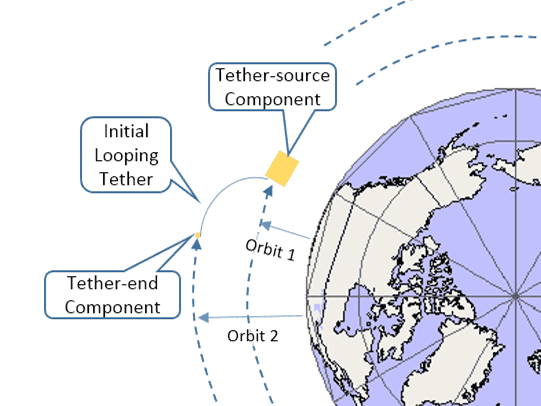

Here's my crude picture of what the Tether profile would look like at Stage 2:
  • #59
SteveO33 said:
.. But my understanding is the Electromagnetic Force - EMF - is the force that plays multiple roles in this situation..
The standard term EMF is used as an abbreviation for Electromotive Force, which is a Potential Difference, provided by a generator of any description. It would help if you used the conventional terms for these things. It has been confusing me (and possibly others) all through this thread.
SteveO33 said:
Since the orbit higher and the orbital period is longer, the far end of the tether will slowly but surely fall behind the source-end.
This is not correct. The equilibrium position will be with the trailing end further from the Earth. The tether will be at an angle to the tangent of the orbits. You could put it in another way and say that the trailing end is constantly 'thrown outwards'. This is exactly what happens on a number of fairground rides (Chairoplanes?) where the chains that support the riders trail behind the horizontal rotating wheel an hang outwards. This YouTube link shows one in operation. You need to interpret the angles correctly because the view is not from along the axis.
  • #60
SteveO33 said:
https://www.plasma-universe.com/Electromagnetic_force
Totally agree... I also said that in my Mar 7 post about the "propulsive tether-end component". So a thruster would fire to move the tether-end component into a higher orbit. That would pull the tether wire from the tether-source component (whether it is just freely unspooling or unreeled by the tether-source). As that tether-end component propels upward, isn't it changing orbit? And since Kepler says that the square of orbital period is directly proportional to the cube of the radius - therefore - with increasing radius, the orbital period is increasing.
Here's the problem: You are trying to treat the object on the end on the tether as if it is free to assume the circular orbital speed at the altitude at which it is at on the end of the tether. This isn't the case. Just putting something at a higher or lower radius does not mean that it will automatically assume circular speed for that radius. It depends on how you put it there.( For example, you can launch a rocket so that its trajectory takes it to an altitude of 300 km, but once there, it will not automatically assume orbit. You would have to give it an additional velocity boost upon reaching that altitude or it will just fall back to Earth.)
Assume we start with a circular orbit, and then give the object a slight inward push and from there it was free to follow a free path(no tether). Then, as it falls inward, it will exchange gravitational potential for velocity and speed up. It will continue to do this until it reaches a perigee point, and begins to climb out again, losing speed as it does so. it will climb until it reaches apogee (which will be higher than its original starting point) before it begins to fall back into repeat the process. What you have basically done is put it into an elliptical orbit that crosses the original one.
Now assume the same situation, except you attach a tether that is being fed from a winch which is set to only feed at the original speed of the push. The object can not change its speed relative to the winch because the winch fixes its speed. And while the object is changing gravitational potential, this potential change is being taken up by the winch rather than by a change in speed of the object. If it tries to move forward faster than the winch, this will tend to swing it to a higher radius. But it can only do this if it gives up speed for altitude. But since it is already moving slower than it needs to maintain a circular orbit, it can't do this. Its natural tendency to to fall towards the Earth, and it will want to settle to the lowest possible point, which is when the tether is pointed at the Earth. It is moving slower than circular velocity for its new radius, and wants to fall in towards the Earth, but is prevented from doing so by the tether. (If you were to cut the tether at this point, the object would assume an elliptical orbit with its present altitude the apogee).
For the object on a tether being fed outward, the opposite is happening, it is moving faster than circular orbital velocity and wants to climb away but is prevented from doing so by the tether.
The difference between letting the object assume a free orbit and lowering it or raising it on the tether is equivalent to the difference between letting an object free fall from a height and lowering it slowly by a rope. After free falling a distance the object has picked up velocity, which it doesn't do if you lowered it by rope.
