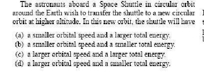

The answer to the problem is a), the orbital speed will decrease but the total energy will become larger. How is this? It's kinetic energy has decreased and the gravitational potential energy should also have decreased from this equation
GM(earth)m(object)/r where r has been increased, thus smaller Gravitational potential energy. Can some one explain this? Thanks

Gravitational Potential energy is negative, so when r gets bigger you potential energy gets less negative, or bigger.
The change in potential is positive.
U(r) = \int_{R{_0}}^\infty \frac{GMm}{r^2}\hat r \cdot d\vec{s} = \int_{R{_0}}^\infty \frac{GMm}{r^2}dr \hat r
U(r) = 0 -\frac{GMm}{R_0}
So as r increases, U(r) becomes less negative.
