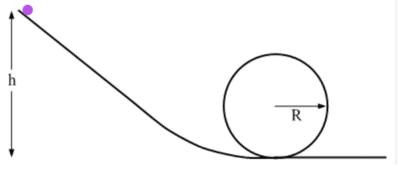

For a rollercoaster if the potential energy is increased (through increasing the height) the speed obviously increases, but what happens to the work done by friction (thermal energy lost) and the average frictional force. I believe it would increase. Am I right?

Your question is not very well specified. Apart from the ”friction” not being very well defined there are a number of other questions about the setup that come to mind (what friction, where, under what interval of the track, how does the track change apart from the drop height being higher?)
Please quote the original formulation of your problem word by word.
The friction of the track on the ball during the entirety of the rollercoaster. Also there is no change to the track apart from the dop height being higher.
Original formulation of the problem:
Purpose: To find the following:
1. What is the relationship between the potential energy of a ball bearing at the top of a roller coaster hill and its kinetic energy at the bottom of a hill after a loop de loop (at the point it leaves the track and falls to the floor)?
2. How much heat (thermal energy) was lost due to friction?
3. What is the average frictional force of the track on the ball bearing?

Surely there must be some relevant dimensions for the rollercoaster height and the loop radius, ect...?
It's supposed to be a experimental lab. The lab involves using a plastic roller coaster in which one end is lifted up, while the loop radius only matters in figuring out the length of the entirety of the track which is 4.22 meters.

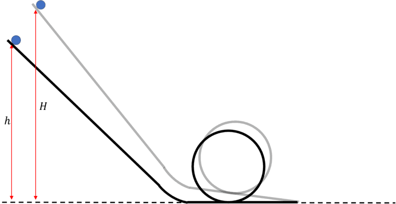

The plastic roller coaster was like the picture below. You would take the first part of the track and just lift it up at different heights not changing the total length of the track.
So you are talking about doing this:
That is absolutely correct.
Well, there are going to be "Normal force" dependent forces like "rolling resistance" that may decline in some regions of the track and grow in others. Drag should be larger for the tilted track since I expect larger average velocities over the entire track.
There is probably a reason why this is intended as a lab exercise. Without doing any calculations I expect the normal force dependent friction changes to cancel out, and the drag to grow.

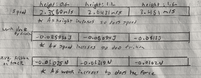

These are the calculations they got although while making the mistake of increasing the length of the track. Through the data they made the connection that when increasing the height of the drop, leads to increases in velocity which subsequently would lead to work done by friction (heat loss) and the average frictional force to increase. Their writing is a little messy.

Will the marble roll or slide?
The marble will roll.
I searched it up and I got an answer saying the coefficient of sliding friction increases with speed, over a wide range of sliding speeds, leading to higher frictional force. Also as there is higher overall friction, the work done by friction would lead to higher amounts of thermal energy (heat). But common sense is telling me that the marble is obviously rolling across the track and not sliding.
You need to be careful about the relationship between questions 2 and 3.
Q3 asks about the average frictional force, but most of that will be static friction as the ball accelerates rotationally. Static friction does no net work, so does not contribute to the generation of heat.
Indeed, it is not clear what Q2 intends. When an object rolls, the losses that turn into heat are caused by "rolling resistance". That covers a range of affects:
  • axle friction in a wheel (not relevant in this case)
  • inelastic deformation of the rolling object
  • inelastic deformation of the substrate
  • bouncing on a rough surface
  • drag
Some writers call it "rolling friction", but a worrying number wrongly just refer to it as "friction".
Drag force does increase with speed, linearly at low speeds, quadratically at higher speeds. I think the others should be constant.
