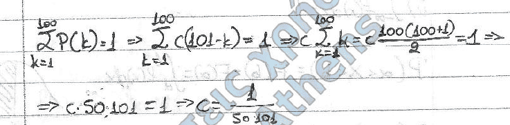

That's not exactly coursework (it's studying) but I've spammed the probabilities forum too much.
Can someone explain this part?
Knowing that P(k)=P(X=k)=c(101-k)
For a 'turtle' that can live up to 100 years, find 'c'.
And it goes
I don't understand the jump from cΣk to c100(100+1)/2
\sum_{k=1}^n k = (1+n) \frac{n}{2}
To see how to get the formula, list the numbers of the sum, then sum the first with the last, the second with the second to last, etc.
Ah, hacky. I was expecting a more straightforward way.
Thank you!
