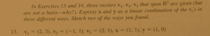

I can't figure out how to do this problem. If you set the matrix up like this
2 -1 2 1
3 1 1 1
You can't solve it because there are 3 unknowns and two equations.

You have only 3 v's. So, in column form, after reducing the matrix:
[tex]V= <br /> \displaystyle\left[ {\begin{array}{*{20}{c}} <br /> 2&-1&2 \\ <br /> 0&5/2&-2 \\ <br /> \end{array}} \right][/tex]
Hence, you can see that columns 1 and 2 are a basis.

Hi Robert
You have 3 2D vectors, v1, v2, v3. as you can see, none is perpendicular to any, but they can't form a basis since they are 3 and the dimensionality is 2.
So any two of them will form a basis.
So for instance, you could have a first basis (v1,v2) a second one (v2,v3) and a third one (v1,v3) and that would be the 3 ways in which you can later express x and y
So for instance, in the first base, you would want to express x in (v1,v2)
(and later y too, but first let's look at x)
How do you express x in (v1, V2) ?
x must be a linear combination of v1 and v2, so x=av1+bv2
x being (1,1) that would mean
av1+b2=(1,1), so a(2,3)+b(-1,1)=(1,1)
therefore you would just have to solve (2a-b, 3a+b)=(1,1)
I let you continue at this point
Cheers...
here are the answers
by using v1 and v2 and setting up the matrix as follows
2 -1 1
3 1 1
I was able to get .4 -.2 which is the answer listed in 13
