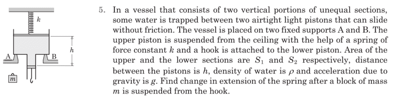

Refer to the image
Refer to the image
Let's say the upper piston goes down by ##y_1## and the lower piston goes down by ##y_2## after the block is suspended \ By volume conservation ##s_1 y_1=s_2 y_2## Let the pressure at the location of the upper piston be ##P_c=\frac{ky_1}{s_1}## Pressure at the lower piston : ##P_a=P_c+\rho g(h−y_1+y_2)## At point of equilibrium , ##mg=P_a s_2## Doing the calculations gives : ##y_1=\frac{mg s_1−\rho hgs_1 s_2}{ks_2+\rho g s_1(s_1−s_2)}## which is the wrong answer . I am not sure where i went wrong .

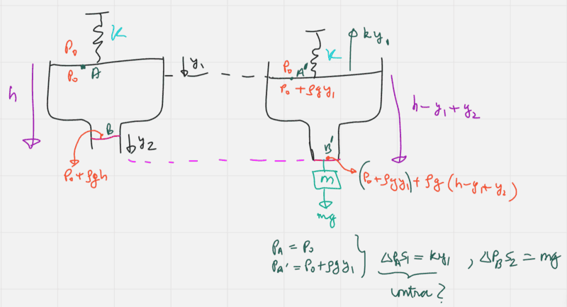

I cannot follow your reasoning from the various expressions scattered around that picture.
Let's go back to post #7.
I queried the ##\rho gy_1## term in the first equation. What is your answer to that?
I agreed with the second equation.
What do you then get for the pressure change just above the lower piston? What force change does that correspond to?
What equation relates that to mg?

Here is my entire thought process , please do help me with the misconceptions that i have : Let's say initially the atmospheric pressure on the upper piston is ##P## and its the same just below it as well . Now , if the upper piston goes down by ##y_1## then the pressure on the upper piston increases to ##P+\rho g y_1## . This generates a force of ##(P+\rho g y_1 - P)s_1## which is to be balanced by the spring force , ##ky_1## . Giving the equation : $$ ky_1 = \rho g y_1$$ which is contradictory . For the lower piston , the change in pressure times the corresponding corss sectional area should be equal to ##mg## : $$ (P+\rho g h - (P+\rho g (h-y_1+y_2)) = mg $$

What about the spring? It is not necessarily in its relaxed state. That is why it is easier to work in terms of changes to forces and pressures.
Eh? Why? The piston does not become immersed in water.
The spring changes length, though.

Ahh i see . I redid the calculations now . If the upper piston went down by ##y_1## then the change in pressure exerted by the upperpiston would be $$\frac{ky_1}{s_1}$$ If the lower piston goes down by ##y_2## , then we can write the forces corresponding to change in pressures : $$ \left(\frac{ky_1}{s_1}+\rho g (h-y_1+y_2) - \rho g h\right)s_2 =mg$$ Doing the calculation gives : $$ y_1= \frac{mgs_1}{ks_2+\rho g s_1 (s_1-s_2)}$$ There still seems to be some slight error as there is a '-' in the denominator in the answer key .
Two sign errors.
When a spring extends, which way does the force it exerts change?
To balance the added mass at the bottom, which way does the force at the lower piston need to change?
Let’s assume for a second that the container is perfectly cylindrical and that we have identical cross-section areas for the upper and lower pistons.
The height of the water column h should remain the same, regardless the magnitude of m.
If you make ##S_1=S_2=S##;
then, ##y_1=y_2=y##
and the equation gets simplified to be:
$$ y= \frac{mg}{k}$$
Because the shape of the vessel in our problem, we have certain mechanical advantage between both pistons.
The upper piston should slide at a slower rate than the lower piston.
Because of the above, ##y_1<y_2##
and our equation will need to have a reduced value in the denominator, which will be achieved with “a '-' in the denominator in the answer key.”
