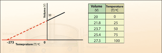

Hi,
Originally, the absolute temperature was thought to be around -273 Celsius around 1750 and it was the result extrapolation of of ideal gas law as shown below. I find it hard to phrase my question. But the question is how come they were so confident that the relationship between the volume or pressure for an ideal gas law is going be stay linear until the very limit of absolute zero? One example comes to my mind of Hooke's Law. It is linear only to a certain limit therefore you just can't extrapolate the data. Could you please help me with it?

Nobody was confident that the relationship would stay linear until the limit of absolute zero is reached. It's just an extrapolation using the ideal gas model. People knew that real gases liquefy and solidify when their temperatures are lowered.
The linear proportional relationship only held near room temperatures if a constant of about -273 C was assumed in the calculations.
Later it was confirmed to hold at lower temperatures.

PainterGuy said:
So, it was more of a fluke?! They just came up with a value for absolute zero using extrapolation believing that the relationship is going to stay linear until the very limit of absolute zero is reached.
Not exactly. There was no fluke about it. They needed a constant to make the math work for their experimental temperatures. That constant is now called absolute zero.
They did not have to assume anything. As they gradually lowered the experimental temperature, in the search for what happens closer to absolute zero, they found that proportionality held and absolute zero remained the same as the original empirical constant.
Just curious about how this proportionality could have been broken. The specific heat capacity does change with temperature meaning that the relationship is not linear. Also, in the picture below from my first post, the relationship between volume and temperature doesn't make much sense once liquefaction takes place. The first liquefaction of gas took place in 1784 as is quoted at the bottom. How the scientists of those days modify their picture of linear proportionality between temperature and volume/pressure since it could have become clear to them that volume cannot go to zero. I think for a solid once solidification has taken place the pressure could be taken to be zero. Perhaps, they switched to temperature and pressure relationship them. Could you please help me with it?
We are considering volume is dependent on temperature. It can be slightly curved, wobbly and approximate. The gas volume = 0 intercept, will be absolute zero.
You must forgo 20:20 hindsight before reading and understanding the history of science.
Obviously not. Solids and liquids do not follow the gas laws. You must experiment on progressively lower temperature gases. Helium is solid below 0.95 K, it boils at 4.22 K. That is close enough to absolute zero to avoid most non-linearities. All you need is a cryogenic refrigerator that uses He as the working fluid.
