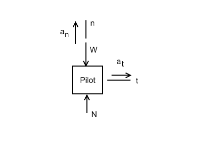

The plane is traveling at a constant speed of 800 ft/s along the curve y = 20(10^-6)x^2 + 5000, where x and y are in feet. If the pilot has a weight of 180 lb, determine the normal and tangential components of the force the seat exerts on the pilot when the plane is at its lowest point.
[tex]\sum F = ma[/tex]
[tex]\rho = \frac{[1 + (dy/dx)^{2}]^{3/2}}{|d^{2}y/dx^{2}|}[/tex]
FBD:
[tex]\uparrow\sum F_{n} = ma_{n}[/tex]
[tex]N - 180lb = (180lb/32.2ft/s^{2})((800ft/s)^{2}/\rho)[/tex]
[tex]\rightarrow\sum F_{t} = ma_{t}[/tex]
[tex]0 = (180lb/32.2ft/s^{2})a_{t}[/tex]
[tex]a_{t} = 0[/tex]
[tex]\rho = \frac{[1 + (4x10^{-4}x)^{2}]^{3/2}}{|4x10^{-4}|}[/tex]
x = 0
[tex]\rho = 2500 ft[/tex]
[tex]N - 180lb = (180lb/32.2ft/s^{2})((800ft/s)^{2}/2500ft)[/tex]
[tex]N = 1611.06 lb[/tex]

Find the algebraic solution and plug in the numbers. Otherwise it is very hard to follow your reasoning.
The force on the seat is the weight of the pilot + the centripetal force. I think that is what you have shown in your diagram.
To find the centripetal force you have to find the radius of curvature. Since this is a parabolic curve, you have to find the radius of the circle that approximates the parabola at the vertex. You seem to have worked that out to be 2500 ft. I don't think that is right.
I think the radius of curvature at the vertex is the distance from the parabola to the focus. The focus is p where x^2 = 4py. Since in this case, 1/4p = 20 x 10^-6 = 1/50,000, the radius, p, should be 50,000/4.

thanks for the help.
I checked the back of the book and the answer is F_n = 323 lb so I looked over my work I made a mistake on the p its 25000 ft not 2500 ft I messed up my derivative of y = 20(10^-6)x^2.
Ok, so the radius of curvature of the circle at the vertex is 2p not p. I stand corrected.
