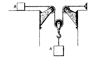

Block on a Pulley: Determine Speed 2s Later
4 replies · 8K views · last reply
KillerZ
116
At a given instant the 10-lb block A is moving downward with a speed of 6 ft/s. determine its speed 2s later. Block B has a weight of 4-lb, and the coefficient of kinetic friction between it and the horizontal plane is [tex]\o_{k} = 0.2[/tex]. Neglect the mass of the pulleys and cord.
Pulley system: block B on a horizontal surface connected by a cord over two pulleys to a movable pulley supporting hook and block A hanging below.

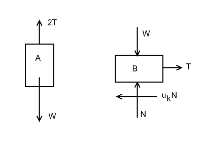

FBD:
Free-body diagram: block A with upward force 2T and downward weight W; block B on a horizontal surface with weight W down, normal force N up, tension T to the right, and friction u_k N to the left.
Block A:
[tex]+\downarrow \sum F_{y} = ma_{y}[/tex]
[tex]10 - 2T = (0.311)(a_{A})[/tex]
Block B:
[tex]+\rightarrow \sum F_{x} = ma_{x}[/tex]
[tex]T - (0.2)(4) = (0.124)(a_{B})[/tex]
[tex]4 - N = 0[/tex]
Kinematics:
[tex]2S_{A} + S_{B} = l[/tex]
[tex]2a_{A} + a_{B} = 0[/tex]
[tex]2a_{A} = -a_{B}[/tex]
Solving for T:
[tex]10 - 2T = -(0.311)(a_{B})[/tex]
[tex]a_{B} = -\frac{10 - 2T}{0.311} = \frac{T - (0.2)(4)}{0.124}[/tex]
[tex]T = -16lb/2 = -8lb[/tex]
[tex]a_{B} = -70.84ft/s^{2}[/tex]
[tex]a_{A} = 83.72ft/s^{2}[/tex]
[tex]v = v_{0} + a_{A}t[/tex]
[tex]v = 6 + (83.72)(2) = 173.44 ft/s[/tex] I am not sure if this is right because that seems fast.
Solving for T:
you forgot a factor (1/2) here.
T = -8 lb is not a solution of the above equaton. Try to give some more detail when you
try to solve for T again.
The negative tension in a rope should have tipped you off that something was wrong.
I didn't have a chance to get back to this but I finally solved it I think:
[tex]a_{A} = -\frac{a_{B}}{2}[/tex]
[tex]10 - 2T = -(0.311)(\frac{a_{B}}{2})[/tex]
[tex]a_{B} = -\frac{20 - 4T}{0.311} = \frac{T - (0.2)(4)}{0.124}[/tex]
[tex]-2.48 + 0.50T = 0.31T - 0.25[/tex]
[tex]T = 2.769 lb[/tex]
[tex]a_{A} = 14.37ft/s^{2}[/tex]
[tex]a_{B} = 15.85ft/s^{2}[/tex]
[tex]v = 6 + (14.37)(2) = 34.73 ft/s[/tex]
I'm sorry, this was an error I missed. a_A and a_B should have the same sign.
this T is not the solution of the last equation. I get 0.19 T = 2.23, so T = 11.7
your also using only 2 digits of precision here, and then give the final answer with much
more digits.
10 - 2T = 0.311(aA)
T - 0.8 = 0.124(aB)
aA = 2*aB
So 10 - 2T = 0.622*aB
T - 0.8 = 0.124*aB
So ( 10 - 2T)/(T - 0.8) = 0.622/0.124.
Now solve for T.
