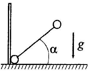

Determine force vs angle, that acts on the vertical wall from the falling dumbbell. Dumbbell falls without initial velocity. The mass of each bead of dumbbell is m.
The problem need to be solved using only Newton's equations by writing them for each of the material points.
I do not know how I find the acceleration of the points.

x=lcosα
y=lsinα
l - the length of the conjunction
x2+y2=l2

(ahh, it's that way round!)
ok, that's the full diagram
now draw the two free-body diagrams, one for each ball, marking the forces clearly on each
I solved the problem. But in addition to Newton's laws, I had to use the law of conservation of energy.
In the projections on the direction along the dumbbell:
mgsinα-R=mv2/l
R - reaction from the rod.
x=lcosα
y=lsinα
Differentiating, we find velocity
v=l dα/dt
The law of conservation of energy: mgl=ml2dα/dt2/2+mglsinα
Using Newton's third law, force, that acts on the vertical wall F=Rcosα
or, finally
F=mg(3sinα-2)cosα

1st ball:
Rx=Tcosα
Ry=Tsinα
2nd (falling) ball:
Tcosα=max
Tsinα-mg=may
sergiokapone said:
Tcosα=max
Tsinα-mg=may
ok, now write ax and ay in terms of α (or write cosα and sinα in terms of x and y), and solve :wink:

I went back to the problem.
For the center of mass of the dumbell I have:
## 2m \vec a_{cm} = 2m\vec g + \vec R## (1)
##a_{\tau}=gcos\alpha##
##v_{cm}=-\frac{d\alpha}{dt}l##
##l## - halflength of the dumbell.
##\frac{dv_{cm}}{dt}=gcos\alpha##
or
##v_{cm}{dv_{cm}}=-gcos\alpha d\alpha##
Integrating, I find:
##a_{n}=2g(1-sin\alpha)##
Substituting in equation (1) of ##a_{n}##
##2ma_{n}=2mgsin\alpha-R##
Finally
##R=2mg(3sin\alpha-2)##
Is the factor ##2## near ##mg## is correct?

I'm not sure what all your unknowns represent, so I can't follow your logic. The lower mass doesn't play any role, so you can ignore it. It has no horizontal acceleration, and since no radius is given for it you have to ignore any KE for it.
I don't get the factor of 2.
But what about the law of motion cernter of mass? In this law we need use total mass of the dumbell. Looks like paradox.
You don't have to treat the dumbbell as a single object. You can treat each end mass and the bar joining them as separate objects.

Ok, but as I said you need to define all your variables. If ##a_\tau## is the tangential acceleration of the mass centre, how do you calculate that it equals ##g\cos(\alpha)##?
haruspex said:
Ok, but as I said you need to define all your variables. If a_\tau is the tangential acceleration of the mass centre, how do you calculate that it equals ##gcos(α)g\cos\alpha## ?
May be, it was my mistake. I think the correct answer is:
##a_{\tau_{CM}}=g/2 \cos\alpha##
Using the law of motion of the center of mass: ##2m\vec a_{CM}=2m\vec g + \vec R## in projection to the tangential direction (##\vec R## - acts along the bar)
##2ma_{\tau_{CM}}=2mg \cos\alpha##
I get ##a_{\tau_{CM}}=g \cos\alpha##
I think, this is my primary mistake.
In that equation, R is the total reaction from the ground. This is not the same as the force along the bar. The difference is the weight of the lower mass.
