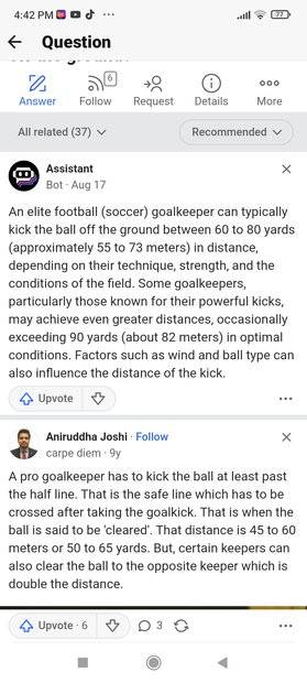

Well @jbriggs444 got 80 meters and I got 77 meters for the .5kg soccer ball. So in the ballpark values according to this link.
morrobay said:
Well @jbriggs444 got 80 meters and I got 77 meters for the .5kg soccer ball. So in the ballpark values according to this link.View attachment 350238
No one is disputing how far a 0.5kg ball can be kicked. The question is how far a goalkeeper could kick a 5kg ball.
If you go down to your local gym and see what a 5kg ball feels like, you'll see the problem - and the absurdity that a professional goalkeeper could kick it 50m.
In case it was not clear, I do not make the claim that my result was biologicaly reasonable. As I understand it, you make no such claim either.
Mine was a back-of-the-envelope estimate based on toy assumptions. I am pleased that it came within a factor of two of a reasonable result.
