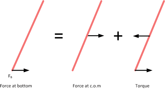

The need for the block becomes clearer now: it exerts a sideways force. Not at the center of mass but at the pivot point. If we slide that up to the center of mass we get a horizontal component (to increase v) but we have to add a torque (opposite to the torque from ##mg\sin\theta## ). Fortunately we don't calculate ##\theta## as a function of time. All we keep in mind is that the center of mass follows a circular trajectory -- until ...

And does normal force from the block does torque?I don't understand why we need opposite torque

But torque from the normal force from the block should be zero as it acts at pivot point
Correct. If you take the bottom end as axis of rotation That's a good way to set up equations for ##\theta(t)##. But we were after the angle at which the centripetal force would go below what's needed for a circular trajectory of the c.o.m.
