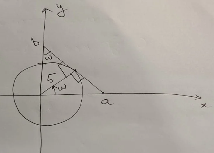

I am trying to understand the variable ##\omega##, since the one-liner solution makes no mention of it.
It seems that this variable is the angle from the positive x-axis to the radius in an anti-clockwise direction, as shown in the diagram below. If that's correct, then the solution should be as below unless this variable means something else.
By using the tangent circle diagram below, I could find the x and y intercepts, which are a and b respectively.
Then I could use the intercept form equation of a straight line, which is ## \frac{x}{a} + \frac{y}{b} = 1 ## to get the general equation of any tangent to the given circle of radius 5 centered at (0,0).
From the two right-angle triangles shown in the diagram above, ##\cos {\omega} = \frac{5}{a}## and ##\sin {\omega} = \frac{5}{b}##.
$$\therefore a = \frac{5}{\cos{\omega}}$$
$$\text{and } b = \frac{5}{\sin{\omega}}$$
Substituting the above in the intercept form of the equation, we get
$$ \frac{x}{\frac{5}{\cos{\omega}}} + \frac{y}{\frac{5}{\sin{\omega}}} = 1$$
$$\therefore {x} {\cos{\omega}} + {y} {\sin{\omega}} = 5 $$
$$\implies {x} {\cos{\omega}} + {y} {\sin{\omega}} - 5 = 0 $$
The above equation is what's given in the one-liner solution, and it represents a family of lines that are at a distance of 5 from the origin, with a single parameter of ##\omega##, which is the angle made by the perpendicular from the origin to a straight line belonging to this family with the positive x-axis in radians ( this angle must be taken in an anti-clockwise direction).
Each real value of ##\omega##, whether positive or negative or zero, will give us the equation of a straight line belonging to this family.
