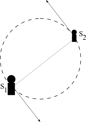

Statement of the problem :
Two ice skaters circle about a point while holding hands. At a certain moment both let go and move along straight lines. Are the two straight lines parallel? Explain.
My attempt : Calling the two ice skaters ##S_1## and ##S_2 ##, they must lie along the same line passing through the centre of the circle at all points. That implies, despite their different masses, they must rotate with the same (linear) velocity ##v##. When they separate, they should move in lines that are tangent to the circle and therefore perpendicular to the diameter to which they were "connected" last. Hence their straight lines must be parallel.
Doubts :
1. The problem is one on angular momentum ##(\mathbf L = \mathbf r \times \mathbf p)## and its conservation. I haven't used any of that in my solution, even if I am correct.
2. If the masses ##(m_1 \neq m_2)## are different, should their linear speeds ##(v_1, v_2)## and radii ##(r_1, r_2)## by the same? Of course, both could be different in a way such that their angular speed ##(\omega = \frac{v}{r})## remains the same.

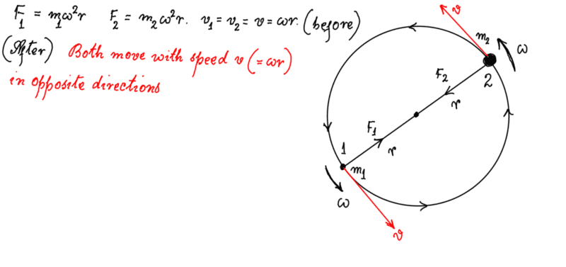

Yes, the problem is, the radii have to be the same, as the problem states : "two skaters circle about a point". Hence the centripetal force on each will have to be different, if their masses are unequal. (##F_i = m_i \omega^2 r##)
I paste below a sketch of my solution to the problem. My conclusion is that both the skaters would move away in lines with the same speed in opposite direction, the lines being parallel.
They can each circle about the same point but at different radii. Indeed, if different masses that is what they must do.

brotherbobby said:
If they revolved about their CM, their relative distance (##r = r_1-r_2##) will change.
Can you explain why you think so? Also their distance from one another is equal to ##r_1+r_2## surely.
brotherbobby said:
the two skaters "circle about a point while holding hands".
I don't see the difficulty.
Draw the two skaters as point masses. Put the CoM somewhere between them. Draw a line through the CoM, connecting the skaters, to represent their arms. Pick some point on that line, need not be the CoM, to represent their clasped hands.
Each circles around the CoM.
