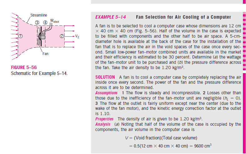

I 90% understand the question and solution but unfortunately I have some hesitations about the formal solution in the book.
Schematic of a computer case with a fan in the middle, showing streamlines entering at point 1 and exiting at point 2 with velocity V2, plus labelled points 3 and 4 either side of the fan and a Welect wire.

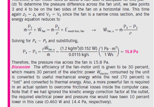

Textbook worked solution: energy equation reduces to P4 minus P3 = rho W_fan,u / m-dot, giving P4 minus P3 = 15.8 Pa, with a discussion paragraph on fan-motor efficiency.
First of all, when calculating P4-P3, choosing lines and points on them, why do book assume velocities of 3 and 4 to be the same?

I'm not familiar with the equations, but at point 3 the air will be sucked in at some velocity 'v' and just at 4 it will be pushed out at the same velocity 'v' excluding any energy losses.
mech-eng said:
why does book assume velocities of 3 and 4 to be the same?
Because the tube diameter is constant between 3 and 4, and assuming in-compressible fluid, the density does not change. Mass flow is constant or else mass would be accumulating. So from point 4 to the end of the exhaust tube, velocity and pressure ideally remain constant. Afterwards, the pressure would normally decrease and velocity would increase, affected by viscous reaction with the surrounding air.

Can we say as one consequence that when fans sucking airs, they just change their pressures at first by fan work?

Looking at the diagram, the funnel shaped tube intake would correspond to accelerating air. Within the cylindrical part of the tube, there would be no net acceleration in the direction of the tube.

Yes, this can be another result from directly looking the scheme but what about deriving a result for pressures?
