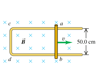

Hello to all. Second post here so I apologise if I post to the wrong place with wrong altitude etc
We have a schematic of a problem like here:
https://www.physicsforums.com/threa...ver-a-loop-under-influence-of-b-field.750763/
The conducting rod ab shown in the figure (Figure 1) makes contact with metal rails ca and db. The apparatus is in a uniform magnetic field 1 T, perpendicular to the plane of the figure. The rod has initial velocity u=1m/s mass m=1kg. R of every conductor is 0 ohm
Initial kinetic is 0.5J. because of the Faraday law of induction an infinite force will halt the rod instantaneously in something that pretty much resembles a plastic colission with a wall. Final kinetic energy of the rod is 0.
Initial momentum is 1kg m/s and final momentum is 0.
As there are no losses in the circuit 0.5 joule must have gone to radiating electromagnetic field and the photons of this field must have 1kg m/s of momentum.
Let's suppose that all the photons are emitted directional (not true) in the direction of the initial velocity of the rod.
There is 8 orders of magnitude discrepancy based on the momentum energy relation for the photons emitted E=pc
What am I doing wrong?

I suspect you aren't correctly juggling with infinities. Why don't you try to solve the exercise in the link (hint by @rude man) and see if a limit R##\downarrow ##0 exists at all ?
Furthermore I can't follow the reasoning with the photons. Does it work when R>0 ?

The attachment you provide do not link anywhere. What I meant was the same figure of the linked post with R=0
The solution with the nonzero R is trivial:
"Induced emf=Bul
Current in the loop I=Bul/R
Laplace force=BIl=B^2ul^2/R
To keep velocity constant you apply an opposite external force
The power of this force is dissipated on the resistor as heat."
Now in my question the only force acting on the rod is the Laplace force which goes to infinity as R approaches zero. The deceleration is also infinite due to Newton's second law. Resistance is 0 so no heat dissipation. The question is "as the rod halts where does the energy and momentum go?". So my first thought was that the energy goes to the electromagnetic field as the loop acts as an antenna with an infinite pulse of current. So I come to your question

To further clarify: If I am correct on energy and momentum radiating (which I most surely am wrong) from the system, even if the direction of the emitted radiation is directional (its the configuration with which you can have the largest momentum with a predetermined energy of photons. If you emit isotropically the total photon momentum is zero) for the energy dissipation requirement of 0.5J photons can only "carry" 0.5/c kgm/s of momentum and not 1kgm/sSecond thoughts on my question
Even if there is zero resistance there must be finite inductance of the loop(otherwise it would not be a loop). The generated loop current induces a secondary magnetic field and the energy is stored there. But the momentum??
In a way, this problem is similar to the two capacitor problem(if you haven't heard please google it. there are some publications on this. Also if you have time please look at sources on flux compression generators where ohmic losses are neglected and most energy is dissipated in a pulse)
My initial intention is at least qualitatively to find a limit (of acceleration of the rod? induced current in the loop?) when the conservation of energy in the context mechanical energy -> heat losses across R do not apply because the radiated energy starts to be progressively important part of the energy budget of the system. The intention is not to find a new theory or prove quantum electrodynamics or relativity wrong :-)
I hope I clarified my question.

At the end, by which I mean after a long time, the rod is moving very slowly, and very small current exists in two very long segments of the two rails. The inductance of the circuit is very large.
Magnetic energy is inductance multiplied by the square of current. Divided by two. ##E=1/2*LI^2##
So the lost kinetic energy has become magnetic energy.At the beginning the moving rod generates an electromotive force: ##U=Bvl##
Voltage U in a circuit with inductance L causes the current to rise at some finite rate. As the current is still small, the force on the rod is small.
The rod is a weak magnet, and there is the strong magnet that creates the 1 Tesla filed. There is a magnetic force between these two magnets. If it's not correct to call the rod a magnet, then we could say there is a force between the electric currents in the rod and the electric currents in the magnet, which conveniently happens to be an electromagnet.What happens between the start and the end, I leave that as an exercise for the reader. :smile: (If I understand railguns corrctly, then the rod experiences a repulsive force from those parts of the rails where there is a current )

Ok, then let's finally do the problem given in #2 and let's be content with the non-relativistic treatment (which is completely sufficient for usual experimental situations in the usual lectures). Let's denote the plane with the rod shown in the figure the ##(xy)## plane of a Cartesian coordinate system. Then the rod's velocity is ##\vec{v}=v \vec{e}_x## and ##\vec{B}=-B \vec{e}_z## (with ##B>0##). Then Faraday's Law in integral form (note that the rod is moving, and thus you need the complete Law!)
$$\mathcal{E}=\int_{\partial A} \mathrm{d} \vec{r} \cdot (\vec{v} \times \vec{B})=-\frac{1}{c} \mathrm{d}_t \int_A \mathrm{d}^2 \vec{f} \cdot \vec{B},$$
where ##A## is the rectangle along the wires and the rod. Now
$$\vec{v} \times \vec{B}=-v B \vec{e}_x \times \vec{e}_z=v B \vec{e}_y, \quad \mathrm{d}^2 \vec{f} = \mathrm{d} x \mathrm{d} y \vec{e}_3$$
and thus
$$\mathcal{E}=v B L.$$
That leads to a current
$$i=\frac{v B L}{R}$$
and a force on the rod
$$\vec{F}=-L i B \vec{e}_y \times \vec{e}_z=-L i B \vec{e}_x=-\frac{B^2 L^2}{R} v,$$
and thus the equation of motion of the rod is
$$\dot{v}=-\frac{B^2 L^2}{m R} v=-\gamma v.$$
The solution is
$$v(t)=v_0 \exp (-\gamma t).$$
Now let's calculate the mechanical energy loss. Since for ##t \rightarrow \infty## it's
$$\Delta E_{\text{mech}}=E_{\text{kin}}(t \rightarrow \infty)-E_{\text{kin}}(t=0)=-\frac{m}{2} v_0^2.$$
We can also calculate how much Ohmic loss there is. The power consumption is
$$P(t)=R i^2=\frac{B^2 L^2}{R} v^2(t)=m \gamma v_0^2 \exp(-2 \gamma t).$$
And thus the total energy converted into heat through the resistor is
$$E_{\text{therm}}=\int_0^{\infty} \mathrm{d} t P(t)=\frac{m v_0^2}{2}=-\Delta E_{\text{mech}},$$
i.e., energy conservation is fulfilled.
