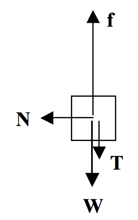

Describe a real situation that would give rise to the FBD of the block. N is normal, T is tension, W weight, f static friction
Fnet = ma
A block glued to a wall, while someone pulling a string down on it.

The glue's effect probably won't count as friction.
Where would the normal force come from ?
The normal force would come from the surface, say a wall

Under what condition(s) would the wall be exerting a horizontal force on the block ?
If you push with a horizontal force, canceling the normal force. Problem is I don't think you can add your own force.

How about if the wall pushes with a constant force ? (In what direction would that have to be?)
What situation would require such a force? -- At least the magnitude of the force might be constant.
Block at rest on a rough wall. Man pulls the string attached to block to balance with static friction?

You need a normal force for there to be friction.
The normal force is generally a "reaction" force, so if the wall exerts a force of N (to the left) on the block, the block is exerting a force of magnitude N on the wall (to the right.)
It looks like there is only one horizontal force exerted on the block, namely N, which must be unbalanced if the magnitude of N is not zero. What would Newton say about that?
Will accelerate in normal force's direction
Person just let's go off block originally held by hand

Then there is no longer any normal force -- once the person let's go.
Yes.
So what is an example of a real situation?

It seems that you are to come up with the answer.
Two blocks on table. Second block accelerating to left, exerting a normal force on first block. Person pulls down string on block.

Think with imagination about a trip to Palisades Park.
Man still not getting it... can someone please offer specific advice? I understand the principles. It must be accelerating to the left, but I can't think of a real life example.

Wow!
Jay gave an excellent suggestion -- to think about (rides) at an amusement park.
Initially, you might not have the tension involved.
How about a larger block (m3) moving to the left which exerts a normal force on m2. m2 is connected to m1 via a string. m2 and m1 have the right values so they do not move vertically; instead they move at the same acceleration as m3.
