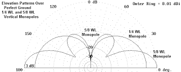

  • Some participants note that the 5/8 wave vertical antenna theoretically provides better horizon gain compared to a 1/4 wave vertical, but practical issues such as multipath RF routes have affected distant reception.

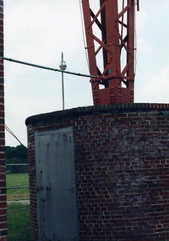

WSM, 50KW Nashville TN. Blaw Knox Diamond 5/8 wave vertical antenna 650khz since 1929, Matching house, coax feed, pictures.

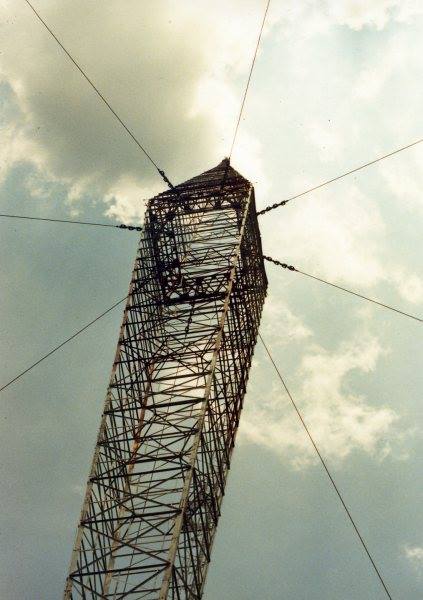

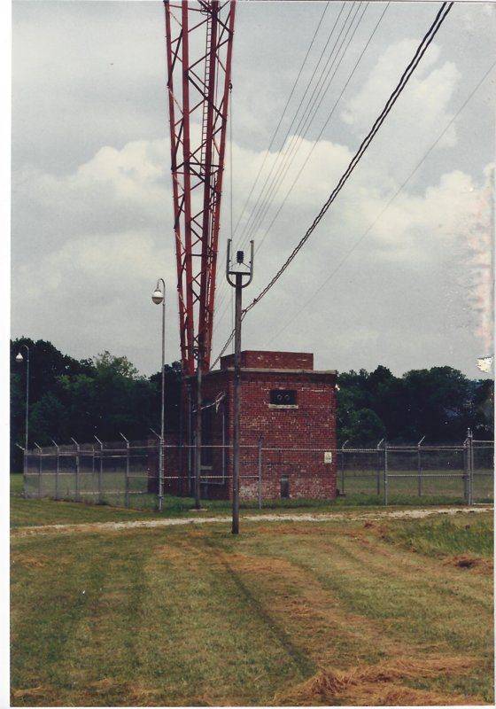

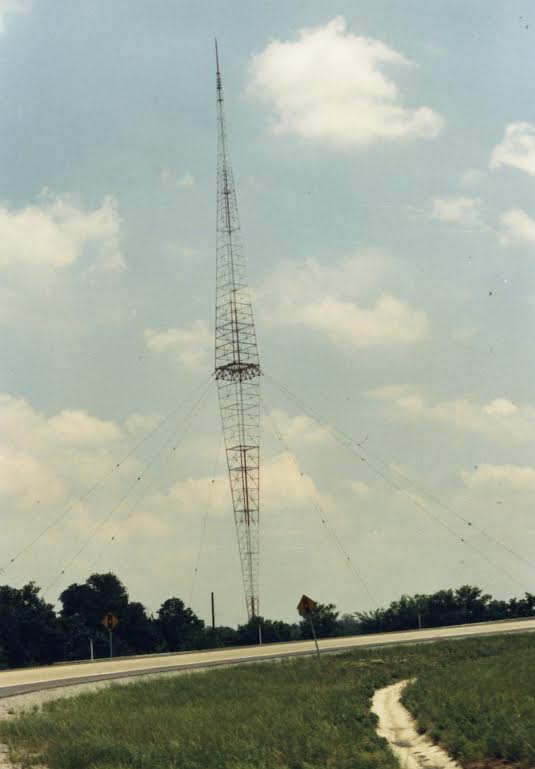

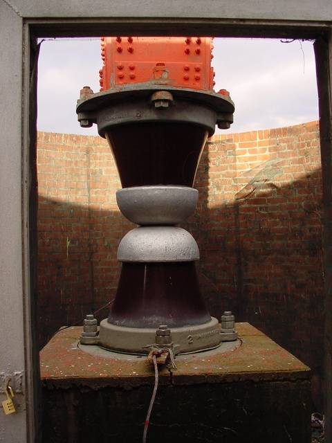

The WSM 50 Kilowatt AM station in Nashville TN, has been transmitting using the same ~950ft 5/8 wave Blaw Knox Diamond antenna, since 1929. The 5/8 wave vertical had some horizon gain over a 1/4 wave vertical so theoretically will serve distant listeners better. It was found though that multipath RF routes combined and canceled at the distant ranges, and some years ago the antenna was shortened a bit to 850-some feet to optimize distant reception. Antenna plus guy weight, weighs 600,000 lbs to the ceramic insulated base insulator The antenna is base fed with a single conductor coming from a tuning house a short distance from the base, that matches the antenna impedance to the coaxial cable characteristic impedance.
Every aspect of the antenna, tuner, coax transmission line, and transmitter is massive. A recent really large lightning strike did major damage to the matching house, and it was rebuilt, since the pictures were taken.

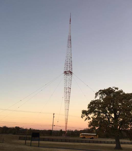

The long wave was probably chosen for maximum ground wave range.
650 kHz; λ = 461.5 m; 5λ/8 = 288.5 m = 946.5 ft; check ≈ 950 ft element.

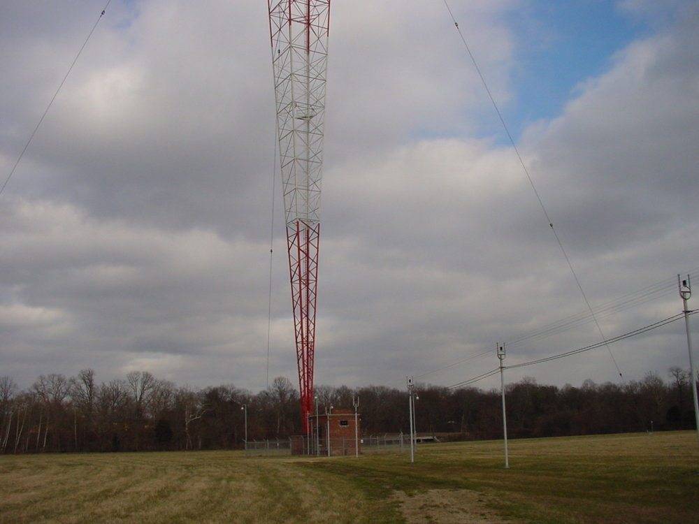

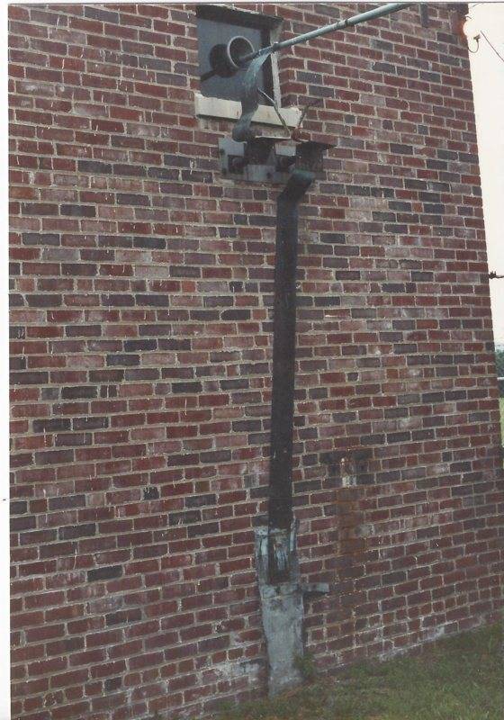

I am surprised there is any coaxial cable there. It looks like parallel cage feed lines to me. As an end fed, λ/2 dipole it would have a very high input impedance, without a ground plane. The Z of a 5λ/8 vertical would also be quite high Z, too high for coax I expect.
So just how was the antenna fed? Against what?
Those early diamond verticals are hard to tune because the impedance along the element is tapered, so they had a continuous mismatch reflection.
A λ/4 wave conical dipole above a ground plane would be easier to match.

No need for help, the Engineering staff at WSM rebuilt the Tuner house, and apparently all is well now.

I think you are right "Baluncore".
A 5/8 wave vertical has more effective radiation to the horizon which is the goal, but has some lobes of radiation at high angles, that interacted negatively with the ground wave, and I think, but am not sure, that the 5/8 needs less of a ground system, than the more common 1/4 wave AM verticals.
But the results at long ranges were not up to expectations, and they determined that the taper of the tower, fat at the center, and needle like at the top and bottom, changed the RF current flow in the radiator from the more predictable current in a straight sided tower, and that accounted for decreased long range signal strength.
performance expected from a 5/8 wave vertical

A 5/8 wave vertical has more effective radiation to the horizon which is the goal, but has some lobes of radiation at high angles, that interacted negatively with the ground wave, at important distances, and I think, but am not sure, that the 5/8 needs less of a ground system, than the more common 1/4 wave AM verticals.
But the results at long ranges were not up to expectations, and they determined that the taper of the tower, fat at the center, and needle like at the top and bottom, changed the RF current flow in the radiator from the more predictable current in a straight sided tower, and that accounted for decreased long range signal strength. View attachment 257669performance expected from a 5/8 wave vertical
Also, in recent years, they replaced the very old but operational 5 wire coaxial-parallel wire transmission line with a large coaxial line, buried. When I visited, it was 1989, and the open 5 wire line was in use. There are now some very interesting videos on youtube with drone inspection flights way up the tower. search youtube for "WSM"

That is dependent on a good Earth Mat. From memory, for reasonable efficiency you need at least λ/4 radius of fairly close spaced radial copper (or aluminium for temporary use) wires. Longer for a 5λ/8 mast, probably. Not all sites have that amount of room.
A 5/8 radiator will help with 'mush, fading and give a wider service area at night.

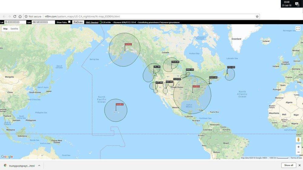

650 khz since 1929 in the case of WSM made it one of less than 10 FCC authorized "Clear Channel" stations in the USA. At one time I think it was the ONLY AM station on 650. As time passed, "Clear Channel" no longer meant exclusive single stations, but few stations in USA. Extensive history of Clear Channel covered here:
https://en.wikipedia.org/wiki/Clear-channel_station
Included is an image I collected with the 650 khz clear channel stations in CONUS, Alaska, and Hawaii.

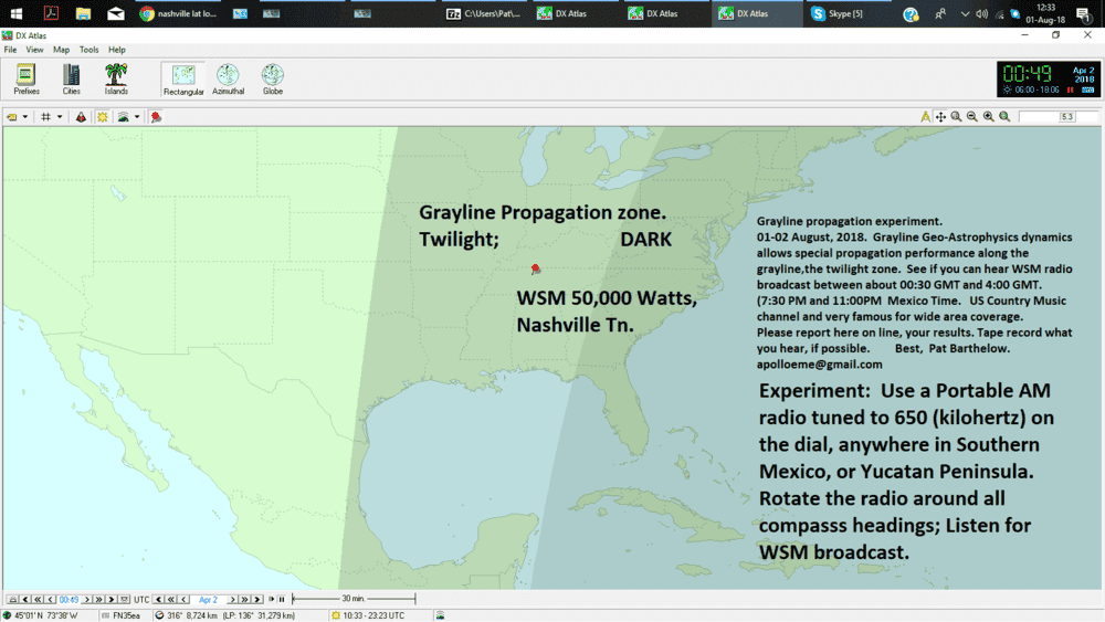

Also a Gray line image that shows the magical propagation-grayline where it might be easy to hear WSM at extreme distances when it is near sunrise or sunset at Nashville. If the grayline is crossing, or close to Nashville, then radio propagation sometimes allows vast distances that WSM is heard, along or near to the grayline, worldwide, at that moment, or for a short time window. The appearance and timing of the appearance and disappearance of the Ionospheric D layer, and changes F1-F2 layers or region, can cause almost a waveguide channel that MF AM band waves can travel long distances.
I am trying, hoping to get some people to tune into 650 in Mexico to see if WSM can cross the Gulf of Mexico, Straight south.

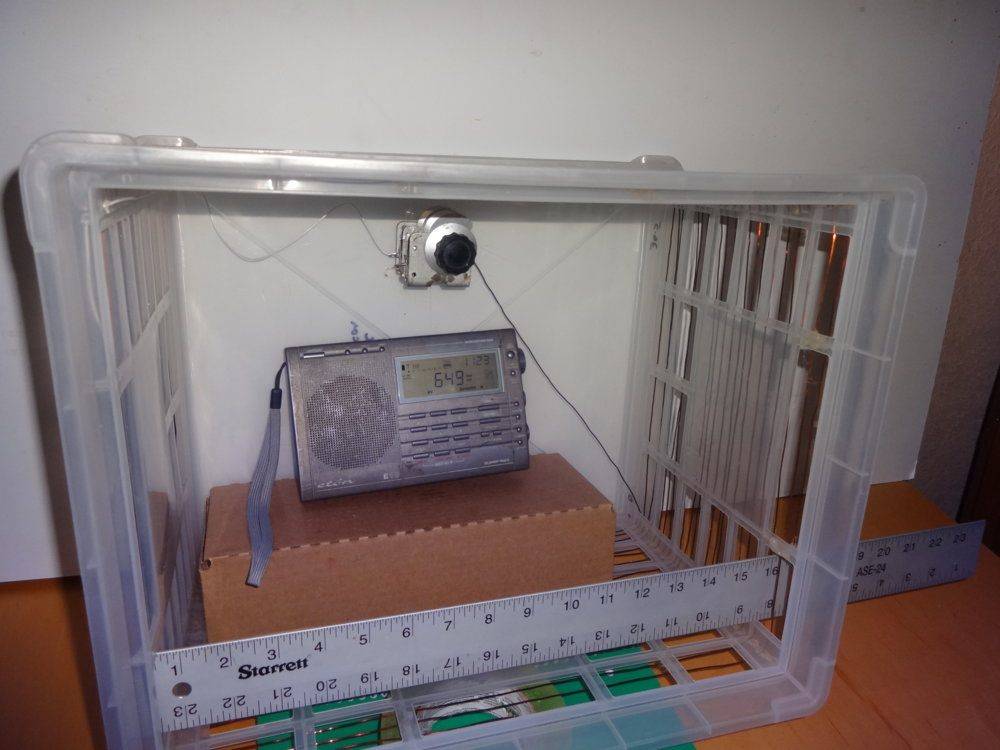

I built a simple AM radio antenna that works very well to enhance reception of table top AM radios without any physical attachment to the radio. See picture. A resonant coil-capacitor circuit surrounding the radio, and tuned across the AM band to bring out the very weak AM signals at night. It is simple and works very well.

The area around the foot of WSM is sufficient for λ/4 radials.
Google Earth Lat/Lon 35.998052° -86.790817°

And 5λ/8 operation is better for space radio wave radiation than for ground wave

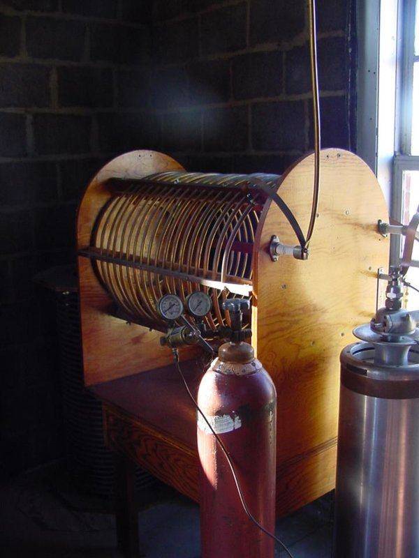

Love those matching coils.

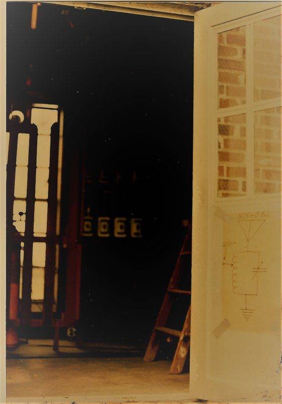

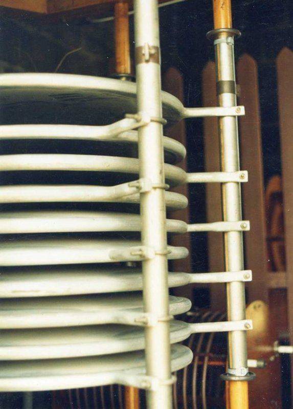

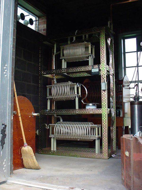

I took pictures inside the matching house, and found interesting the stacked, spaced "pizza pan" capacitor plates. When a friend of mine and I got the insider's tour, first of all my friend was a history professor, and all this stuff looked like a Tesla science fiction laboratory of old to him and he did not fully understand it, and was a bit uncomfortable. Everett, cautioned us to just look, do not touch ANYTHING in the tuner house or get too close as WSM was on the air at 50KW AM (~ 250 KW peak to peak modulation. We all took a step back inside the tuner house. :-) Then, it became apparent to me that I/we could hear the faint but clear modulation of country music. I smiled and mentioned "what's that sound" Everett said the 50KW AM modulated power was vibrating the ~20" dia capacitor plates putting off clear but soft audio. This unnerved my friend who was driviing.. who said "Pat, I'm leaving." "I will be in the car, meet me there, when you are doing looking at this thing." :-)
Also a copper tubing coil, homebrew on a plywood wooden form. The coil had a twin that was interesting. Each turn of the copper was anchored by a sawtooth cut into the form, constraining movement, keeping spacing uniform.
One of the retired coils still on its plywood form, had nearly every turn flattened, as if a steam roller rolled them flat. Everett explained to me that a long ago lightning hit with possible, say, 10,000 amps or more current, produced so much turn to turn repulsive force that the forces crushed flat the tubing, which was about 1/2" dia.
