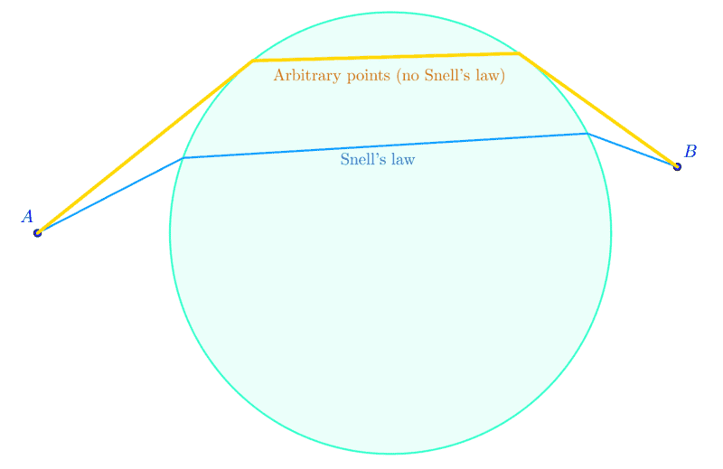

lemma28 said:
Consider a light starting at A in media 1 and going in and out a media 2 (say shaped as a disk) with relative index of refraction n to arrive at point B (in media 1).
Fermat's principle says that the path taken by the ray between points A and B is the path that can be traversed in the least time.
That could be misunderstood by thinking that the "least time" path from A to B and through the disk is the path taken by the light ray, and the one following Snell's law at the surfaces separating the two media.
That's not true. Actually there are paths (orange broken line) that do not follow Snell's law that produce a smaller time than the one produced by the path following the Snell's law (blue broken line).
Actually Fermat's principle says that the time of the path taken by light (following the Snell's law) is a local minimum with respect to nearby paths.
That doesn't prevent the fact that there could be a global minimum for the time following a different path.
I'm posting this note because I was myself victim of the misunderstanding.
Any comments? Any suggestion?
(in the simulation n=1.8, A(-1.6, 0), B(1.3, 0.3), r=1)
If I understand correctly, the orange path is faster because the index of refraction is high, and the traversal through the m2 medium is shorter. Interesting, I have to think about it more, but maybe you're just describing rainbows.
