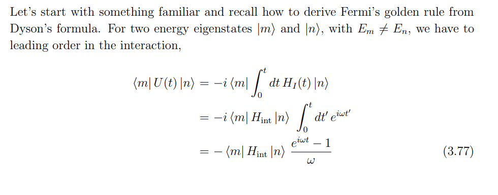

I am stuck between line 1 and 2 in the derivation below. I have attached what I tried
My thought is following:
However this would give me w=E_m + E_n instead of E_m-E_n
I guess something relating to hermiticity or adjointing something has gnoe wrong in my version.
Can someone point me in the right direction please? :)
Thank you in advance!

Are you sure you didn't get ##\omega = -\left(E_m + E_n \right)##? Then I would have replied that, in Dirac notation, the bra - ket is conjugate linear in the bra, i.e., if you pull a scalar outside of the bra, you have to take the complex conjugate of the scalar.
I do get the required result.

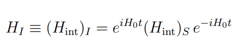

I agree with George. Focus on your ##e^{i H_0 t}## which you turned into ##e^{-i E_m t}##.
So ##<m|e^{i H_0 t} = adjoint(e^{-i H_0 t} |m> ) = adjoint(e^{-i E_m t} |m> ) = e^{ i E_m t} <m| ##
Is this correct?
(if this is correct then everything makes sense)
Is this correct?
Yes, this is correct.
